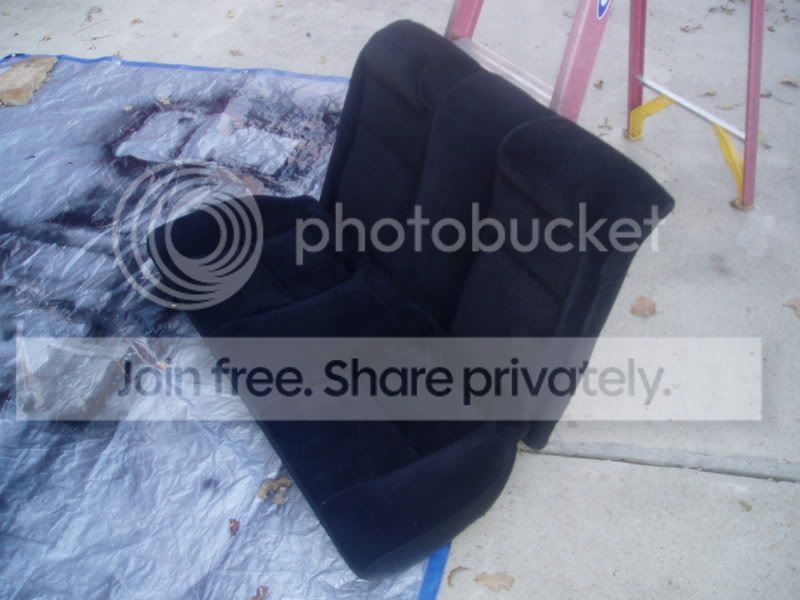

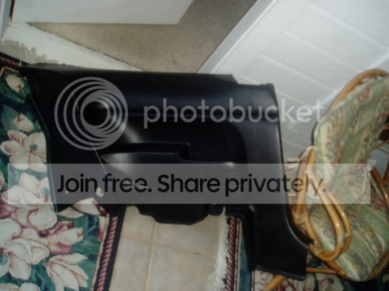

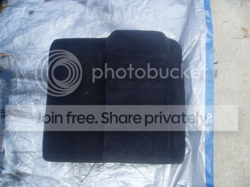

Hey ive seen this post a few times about people wanting to convert their interoir to black... im pretty sure there is not replacement oem civic parts that are black.
so i went to orileys and got some dupi-color gloss black vinyl and fabric spray "die"
so far i have only torn out the rear seats and panels to paint them. and so far this is how they look
now the seats dont crack, or smudge and the panels i cannot seem to scratch with normal items.
However, the seats are not as soft as they where they are kind of "crunchy" and they smell, but im assuming they just need to be broken in and aired out.
ill keep updating as i go throughout the car..

yeah it was only 3 cans at 6.49 a can to do that.. and i still have half a can.. i only threw 2 coats on seats and 3 on the panels..
i was honestly not expecting them to look that great but they came out extreamly well!

well today in texas its like 60s so idk how it will hold up in cold weather and idk if i ever will.. but so far it seems to be holding pretty well. the panels i tried to chip with my fingernail, rubbing it with a dry sponge, and its not seeming to do anything i guess if its applied lightly and gone over and over and over... ill keep updates going on it for yal

When you do the seats make sure you let them dry then brush them with a stiff bristle scrub brush. It will knock all the loose stuff off the fabric. Do several coats in that manner.

yeah thats what i did for the rear seats, im not painting the front tho... im getting black ones pretty soon..
