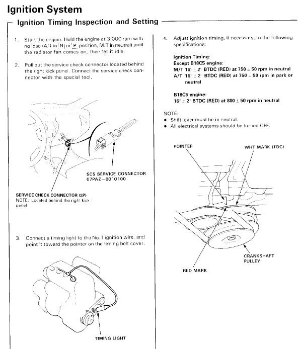

You mentioned "playing with the ignition timing". Have you followed the service manual procedure to the tee with the service connector jumped and using a timing gun?
Does the CEL work?

hey thanks for the replies. the firing order is correct, when i adjusted the timing i shorted the service check connector and moved it in small increments until i got it where i thought it should be, i used a timing light on it but was during the day and wasnt able to see the marks on the pulley very clearly. yes the CEL does work, it would throw code 15 (ignition output) when i had the old dizzy on it and cranked the motor for few times, when i short the service connector the CEL comes on and stays on (no blinking). The distributor i ordered was CARDONE SELECT 8417408. i am curious about maybe taking the ignitor from the new dizzy and putting it in the old 1 to see if itll start, its just raining right now.

The ignition timing is set by aligning the pointer on the timing belt cover with the red mark (middle mark in group of three) on the crank pulley. The engine also must be idling to spec. Is that what you did?

so i just used a timing light to adjust the ignition timing, when i was looking for the 3 marks on the crankshaft they appear to be way forward (towards the front car car) and wont line with the mark on the lower timing cover even if the dizzy is all in way in 1 direction or other. does this mean have have to re check the valve timing again?

If you can properly set the ignition timing, then by definition, the mechanical timing is fine. If not, the mechanical timing is off, assuming your engine is idling to spec.
