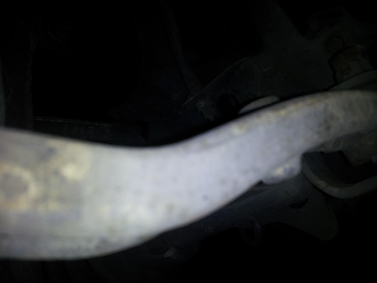

These LCAs were removed from an original, unmolested '93 Del Sol Si.
Note the L and R markings.

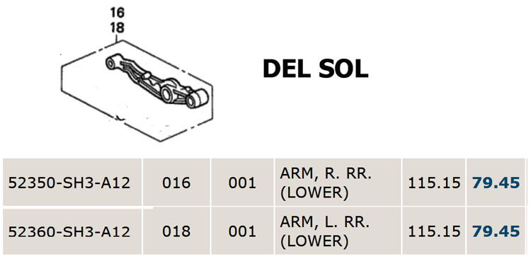

I did a little online research.
First: both sides are available for the Del Sol, at Majestic Honda. Majestic Honda - The Internet's #1 Honda Automotive Parts Store
see picture.
I then checked a hatchback at Majestic, and they showed two styles: mirror image and interchangeable. Only the interchangeable being available.
see picture

I believe the mirrored ones for the hatchback that are not available you found are for the JDM hatches that received the rear sway bar. As you can see there is the bolt hole provisions for it.
If I remember previous discussions correctly, none of the north american hatchbacks ever had sway bars.
These first two photos are the rear LCA for a stock 93 civic hatchback CDM:
As you can see, no sway bar bolt hole provisions and straight as an arrow.
These next two pics are from a 94-97 Integra:
As can be seen, there is the sway bar provisions and there is a pretty strong S curve.
