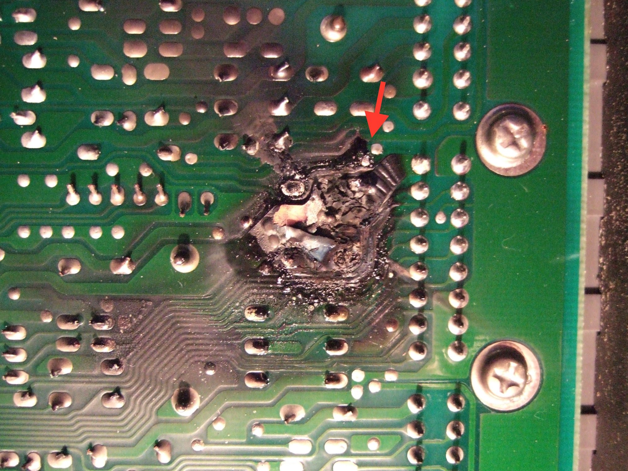

meich75 kindly sent me his bad P06 ECU.
I removed the top and bottom ECU lids. The problem was immediately evident. Main capacitor C14, which supplies 5 reference volts to many sensors (e.g., MAP sensor and TPS), clearly blew and damaged the printed circuit board (PCB). The PCB must be cleaned up and the bad capacitor removed to see whether the damage is reparable.
Bottom:
Top:

Thanks for posting your findings so far and the pics. Interesting to see that it was that bad.

that is a nice burn!
