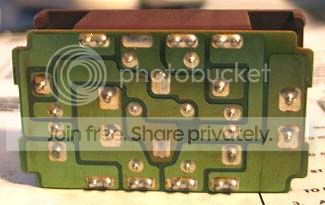

now i have a spare/bad main relay, decided to do some experimenting and took it apart thinking i would be able to clean the contacts and resolder loose connections. the relay is seal tight. there is no taking this thing apart without damaging it.

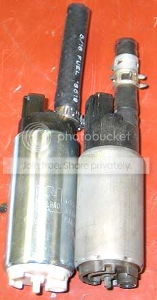

a comparsion between a walboro fuel pump and the stock pump

That's what we do all the time. Just resolder the connections and the main relay is good to go. Most of the time it's the leads to the inductors (as shown in the ckt diagram) that gets bad, giving the hesitant fuel pump problem and starting issues. Cheaper than spending another $80 from the dealership getting a new one, which I've seen many people do.

i used the link above to solder mine, it worked out even though i have never soldered on pcb before, i think i used too much , but it hasnt been a problem
