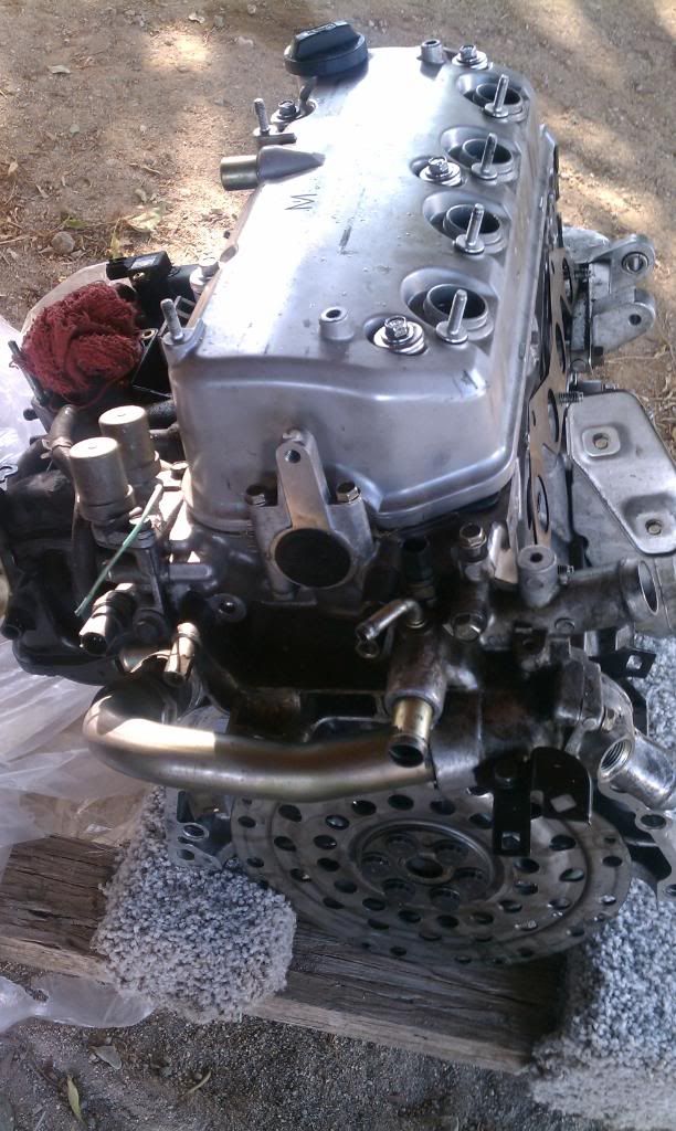

I just recently bought and installed a D17A2 into my 2002 honda civic LX auto. I know the motor is what comes in EX models but I noticed where the vtec solenoid there's two of them instead of just one?! I'm wondering if there were any dual/3 stage vtec d17? or did the shop I bought it from just put a solenoid from a d15b 3 stage vtec on it? also How would I wire this to a vtec controller or would I need to get an ECU?

I saw that FAQ post, but thing is my new engine came with two vtec solenoids instead of one. The block says D17a2 so Idk why it has two solenoids

Pictures of said "dual solenoids"?

A D17A2 only has one solenoid valve. Not sure why that's on there.

I have to admit, that is quite bizarre. I don't think it belongs there, to be honest.

the head looks like the one we have here in asia with the two solenoids. but 1600cc.

So would I be able to swap just the vtec solenoid from dual to a single one? Or can I just hook up the green wired solenoid? I'm lost here and I've searched other forums too.....

That almost looks like an auto tranny solenoid set. I suggest you get the correct single solenoid and use the FAQ DIY to wire it up.
