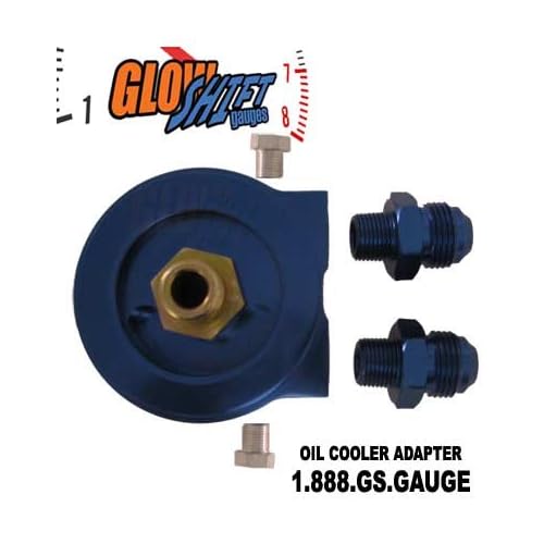

just stay away from this

Why is that?

i bought it with the intentions of putting in an oil cooler at a later date. i still installed it for the senders i'm using. well when i capped the top, that cut off any oil supply unlike this design
caused the other engine to suffer oil starvation and almost blew the ls in there now if they hadn't caught it in time. was my fault mainly b/c it was my first time dealing with oil sandwich adapters and i didn't know any better

I had a golden eagle sandwich plate on my ls turbo and it worked great, car looks awesome man

looking good blu, you know it just dawned on me that you said the seller of that first motor refunded you money for it, come to find out, it was the oil sandwich... lolz COME UP!!! hehehe BTW, my SEMA badges just came in the mail... Funny since the show is tomorrow... lolz
