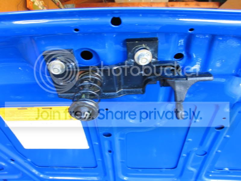

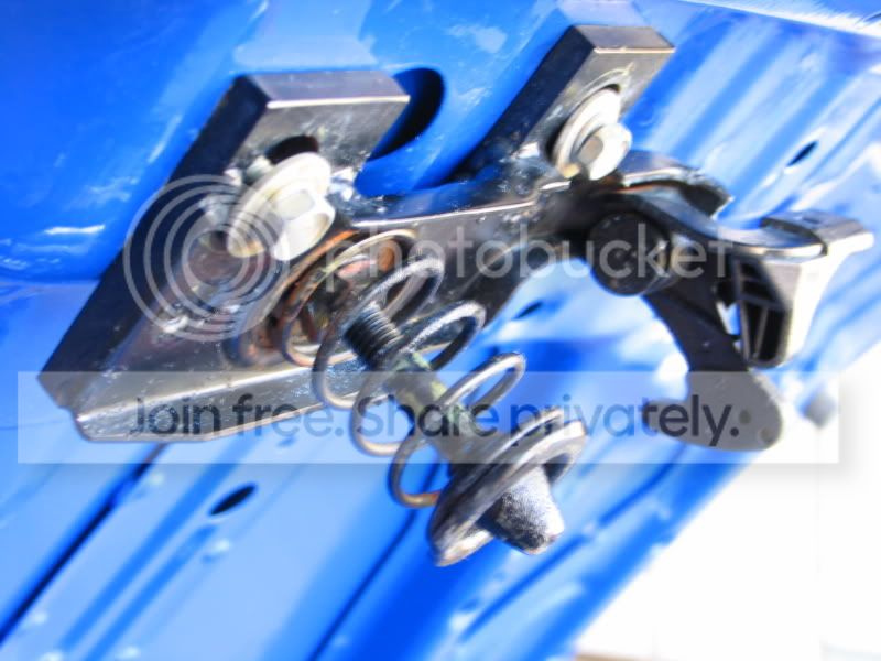

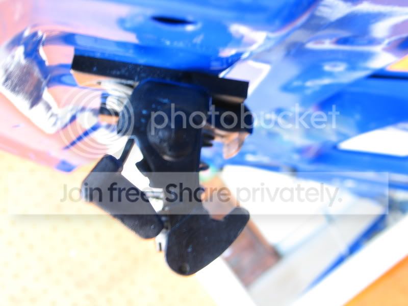

For those that dont want to cut the crap out of their t-bar support for the JDM hood you can weld some 1/4" steel plates to the stock hood latch to make it work. This puts the latch and almost a perfect angle so that it wont come unlatched-

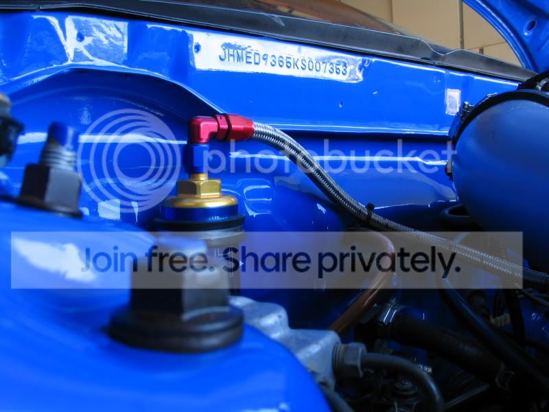

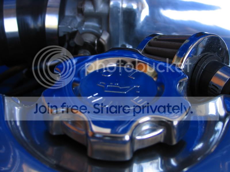

Messin around in the bay a little the other day so I took a few shots-

what are those radiator brackets? custom? secret?

Custom radiator brackets, I made them from stainless.

On another note, DAMN!!!! your engine bay is clean. How often do you drive it?
