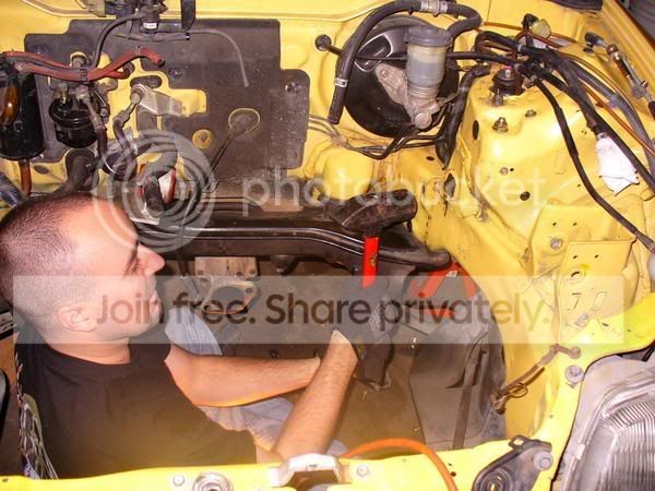

I know you have to bang the frame rail in to fit a B into a crx, just wondering if anyone has any pics maybe.. want to make sure its right before sending the car to paint.

Just right where the alternator pulley hits and if you want AC it may be a good idea to bang the hump near where it hangs in a tad bit too. Maybe 1/8th to 1/4" at the a/c part. It fits but its somewhat of a pita to get a belt on in the tiny bit of space thanks to the rivets on the compressor clutch.

heres a perfect example from the threads own CRXbart

You can drop a bseries in an ef without banging the rail in. Just use a smaller alternator belt and the alt wil hug the motor more and clear

<TABLE WIDTH="90%" CELLSPACING=0 CELLPADDING=0 ALIGN=CENTER><TR><TD>Quote, originally posted by HatchMo &raquo;</TD></TR><TR><TD CLASS="quote">heres a perfect example from the threads own CRXbart
http://i12.photobucket.com/alb...t.jpg</TD></TR></TABLE>
no safety glasses?

yep there ya go
LOL! that's funny stuff right there. I have the caption on my myspace under that as "punish the Y curse!" LMAO!

<TABLE WIDTH="90%" CELLSPACING=0 CELLPADDING=0 ALIGN=CENTER><TR><TD>Quote, originally posted by thevtecnician &raquo;</TD></TR><TR><TD CLASS="quote">You can drop a bseries in an ef without banging the rail in. Just use a smaller alternator belt and the alt wil hug the motor more and clear </TD></TR></TABLE>
Thats a good idea too.. i just bought a new belt! easy return though.
thanks for all the pic's and info on this.. im gonna go bang some metal anyway! no safety glasses either!
