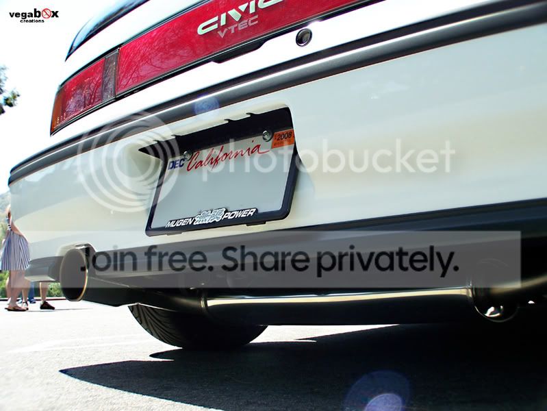

The answer is yes! It does rub but it isnt impossible to fix. I have to adjust the hangers or space the sway bar down a tad. Its annoying but not unbearable.
This is with the invidia EF9 Catback with ST rear sway bar.
I run the SP2 also... ive ran it on my hatch and now on my crx. Im pretty sure its 2.5inch piping. I Run strait 2.5inch piping from the header back with no cat and i love the way it sounds.. A cat may quiet it down a little bit. havent installed my sway bar yet, but it doesnt even look close to hitting the stock bar.
Only complaint is the huge rear tip. it fits the car well, but i think it just draws to much attention, id like to cut it off and weld on a regular tip, or even a nice bent tip like the toda exhausts come.
