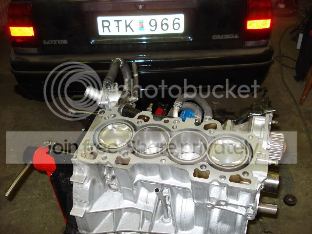

i thought i bought wiseco 9.1 but when i got them i checked my wiseco kit-number on their webbsite and then i got 8.3-8.6
my kit number is k541m815
is it much difference between 9.1 and 8,3?
i have a b16a1 and planing to hit 350whp with a garrett 57trim, itr cams, ramhorn and eagle rods
[IMG][/IMG]

That part # is calculated for a GSR Motor, 81.5mm bore and 8.6 - 8.9 Comp Ratio. In a GSR...
You should have ordered, K542M815, which would have been 8.8 - 9.0 Comp in your B16.

you'll get about 7.7-8.2:1 C/R

i would run that compression. don't let the "too low" compression scare you. you can run more boost/power and still be very safe even on 91oct fuel.
higher compression just makes it a little trickier to tune....i highly doubt you will notice/feel any difference between 8:1 to 9:1
i had the same wiseco 8.XX:1 pistons and i switched to JE pistons and shaved the head enough to run about 9.5:1cr......the difference was hardly noticable....

i checked the comp caculator, and if i take away one layer if the headgasket and milled the head down maybe i should get 8.0
Old Dec 29, 2007 | 01:19 PM
anton_'s Avatar
Posts: 218
From: umea, sweden
Default Re: wiseco komp (anton_)
the piston comes out of the cylinder by 0,25mm thats about 0,01" if i put the head on without a gasket the piston hit the head a little bit. i can pull the engine around by hand, so it is very little.
is it somethin to wory about?

if the pistons stick out passed the deck of the block the compression will be much higher than what you originally calculated.
sounds like your machine shop machined the deck of the block alot.......

you might be able to......have it properly measured at the machine shop.

I wouldn't run less than .025" piston to head.If your up .010" than i would run the stock hg unaltered.Your real choices are change the pistons to a true 9:1 or run what you have.Like has already been said the low ratio isn't that bad.

just about all the shelf pistons stick out of the hole on b16s. do not take a layer out of the gasket the pistons will hit the head if the piston to wall is real loose you might want to put a thicker gasket on it. allso make shure the gasket has 0 overhang into the bores. or you can just take the motor back apart and take the pistons to your machine shop and tell them to take 25 of the tops
