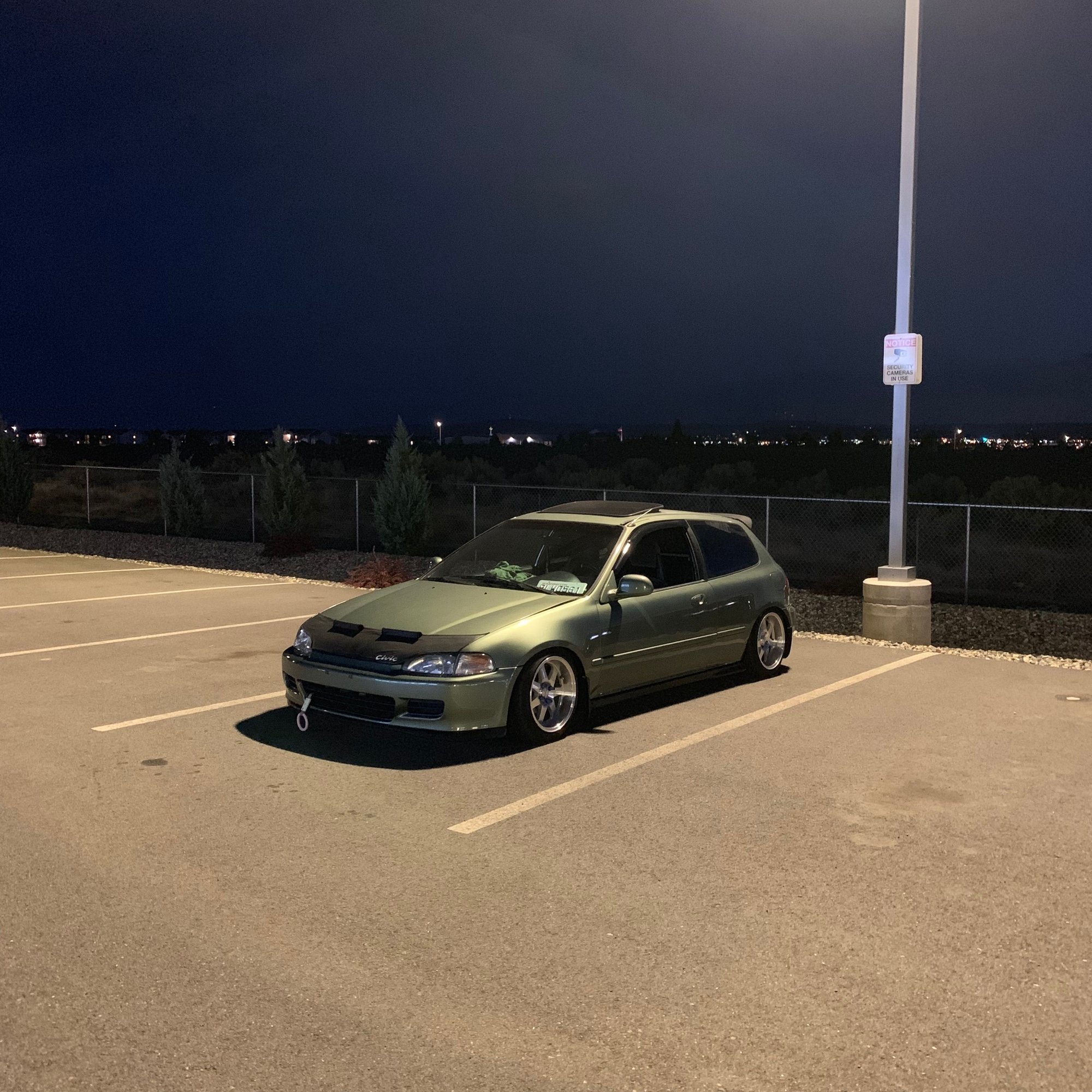

My car:

To be honest I would be a little weary about going turbo since the room for error is very small since your using a stock rod and piston. If you had forged pistons and some good rods I would not think twice after changing over to a better software. It’s a very nice setup you have but it was built for a single purpose , this is just my take .....others may differ. Love the car though, nicely done!

Nice EG Si Hatch.

Nice EG Si Hatch.

Thanks for the compliments guys!!
