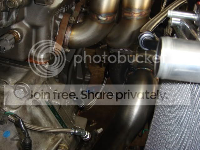

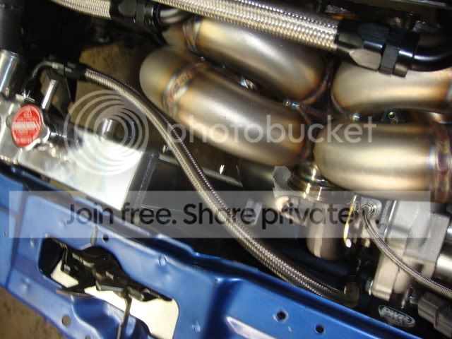

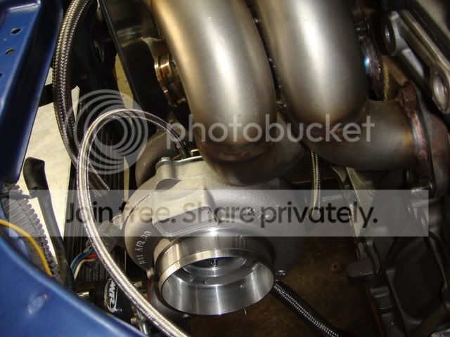

Just so the OP has a full idea on how everything comes together

<TABLE WIDTH="90%" CELLSPACING=0 CELLPADDING=0 ALIGN=CENTER><TR><TD>Quote, originally posted by a1320addict &raquo;</TD></TR><TR><TD CLASS="quote">http://i147.photobucket.com/albums/r...t/DSC03016.jpg
http://i147.photobucket.com/albums/r...t/DSC03017.jpg
http://i147.photobucket.com/albums/r...t/DSC03018.jpg
Just so the OP has a full idea on how everything comes together </TD></TR></TABLE>
Thanks for the in depth pics...helped me out
