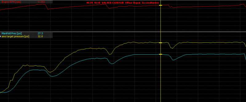

Here is a snapshot from a motec log file of a customers . There are ramps applied as well
AMS TARGET Pressure in yellow
Manifold pressure in blue
high psi low psi
first gear 19.7 19.6
second gear 25.4 25.3
third gear 27.3 27.2
fourth gear 27.4 27.3
Modified by NLR at 5:49 PM 6/29/2007

thats sick! my turbo starts shitting itself in 4th anything above 35 or so that log should sell conntrollers by its self!
