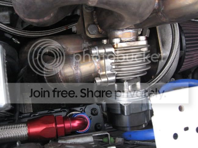

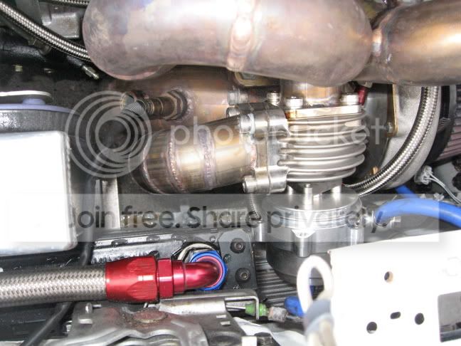

here is a pic of the new set up, & powder coated rims with bfg drags

Did you weld the flange with the valve seat directly to the manifold? You're supposed to weld the flange they give you to the manifold and then the thin flange with the valve seat machined into it sandwiches between the gate and the flange.

yes thier is a little metal ring that is tapperd between the flang & wastgate. its the only flange they sent. it seemed to go together correctly.
i had to over night the dump flang cause i didnt know it was seperate. i dont know why cause the 38 comes with both when 46 cost 2wice as much

Hmm, all the 46's i've ever bought have come with the inlet and outlet flanges. Was it an opened box when you got it?

it seemed to be new box, but thiers really no telling. even if i did do it wrong it works great.oh well i want to make it to moroso this weekend so gota do what u gotta do.
