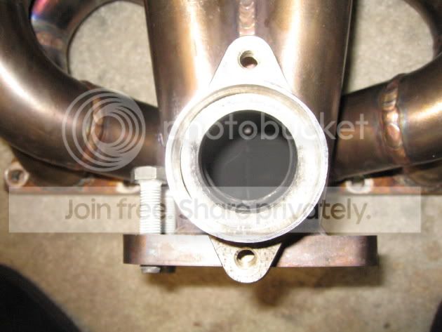

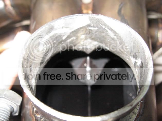

well after taking everything apart & looking at things thier are flow flaws in the mani. u can see inside the flang that thier is a big lip where the flang bung meets the collector. also where the pips come together in the middle it sticks into the flang area blocking some flow from the back 2exaust ports.
i will cut the inside section sticking down about 1/2 inch up & weld a small tip on it.
aslo u can see the new bung sitting on top of the flange so its alot more diameter thier. i will port the hell out of the new piece once its welded on & curve the inside real nice. ill post pics when its done.
so with all that said ill say neukin makes a good sturdy mani with good welds but doesnt clean the inside up for better flow.

i dont think its the a build factor cause the quality is good he just didnt go back in after & clean it up. cause theirs no where else to put the bung
but i guess thats what people like me are for to fix other pepoles flaws.

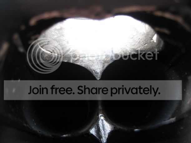

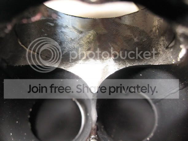

Tony1: You wanted to see the inside of a Neukin manifold? Here´s a pic.

<TABLE WIDTH="90%" CELLSPACING=0 CELLPADDING=0 ALIGN=CENTER><TR><TD>Quote, originally posted by Pabbe &raquo;</TD></TR><TR><TD CLASS="quote">Tony1: You wanted to see the inside of a Neukin manifold? Here´s a pic.
And that is why they boost creep so bad...
Oh wow. I wonder why he uses that size of hole saw. The one I use (think its 1 and 5/8") fits the ID perfectly.

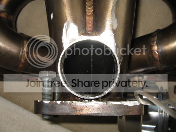

well here is the pic of the new bung on its not real thick but its only 3/4 long so it should hold.

Make sure you brace your WG.

I don't really know what you guys are pointing out as to problems with this manifold creating boost creep. Here's a pic of mine. Same thing?

Its quite obvious really... Read the above one move time Its the hole for the WG

ya i had that planed cause the wg alon is alot heavyer alone. & i believe most manis crack from heat "and" weight hanging on it. om going to weld a brace onto the dump tube going down to the front cross brace
with a bolt should help alot & i dont have to worry cause my motor doesnt move at all.
& i dont know the center of that collector looks a little dull u shuld sharpen it
no but really at the top part of your collector i can see light hitting the 2 points from the WG hole that will effect your flow out. i would grind all pertruding metal down & away

well firs i am going to a 46 tial. secons neukin doesnt make his mani the way they should.
the exaust flange was warped so they put a beed of weld about 1/8 wide arouns
exaust 1 exactly where the crush gasket line is then sanded down flat . when they
should od just sanded the whole thing down more & got the whole thing flat.
i called them about it they said send it back we will fox it well i dont have
time for that i had it done locally witch cost $$$ & now im fixing his wg port.
witch yes im going to a bigger size but as the pics showed thier was alot of
flow design error due to not cleaning uo welds wct. as the same with the ohter
neukin mani pics.
