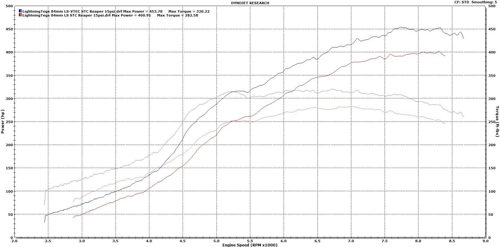

This is my Interceptor on 15lbs, 84x89 LSVTEC, CTR Cams, E85 (Blue)

How do you like the respons of it? Between shifts etc.. Beautiful graf, tourqe is pretty nice and flat and spool is fast. Did you stop there at 15psi? I would have loved a 30+ psi graf.
Whats your speces on the exhaust side? I would have expted a little higher power at 15psi on a 62mm turbo in general I guess.. What cams?

For a turbo that can do 700whp, its very impressive how well it drives and how easy it is to modulate power with throttle input. I haven't had a ton of seat time or a chance to race it on a road course (ultimately the purpose of the car) yet though.
My fuel pump dyed on the dyno right when I started to turn up the boost. I replaced the pump but never ended up going back to the dyno and just street tuned it to 30lbs. I will tell you definitely over 600whp based on acceleration logs and the injector duty cycle.
