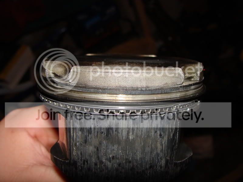

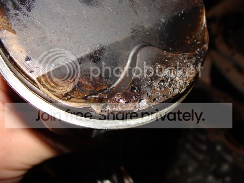

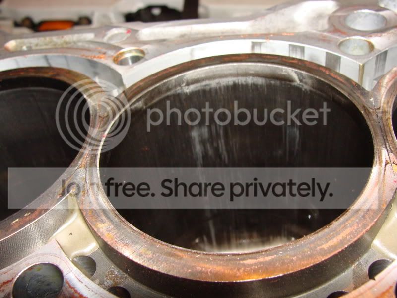

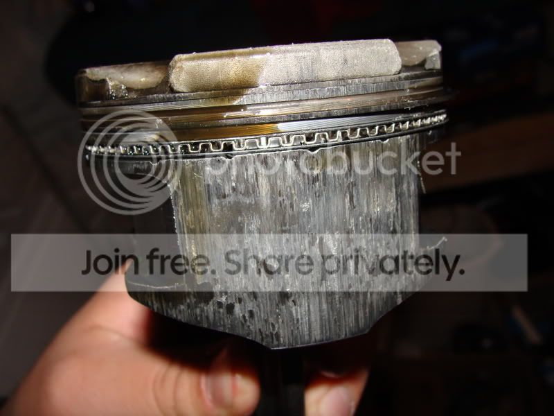

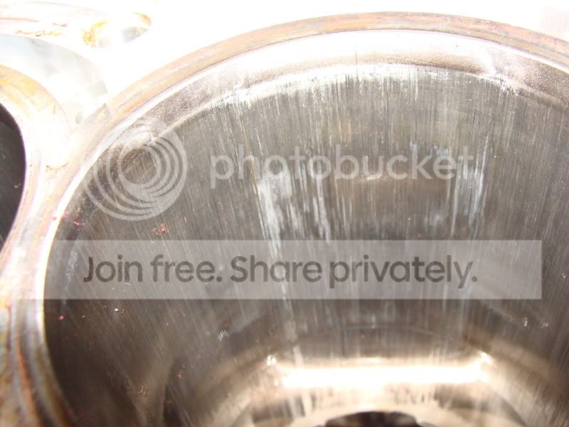

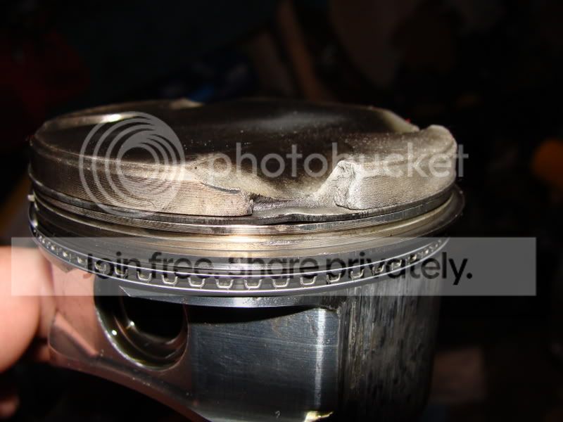

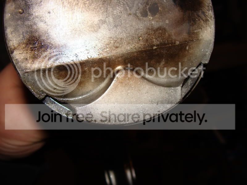

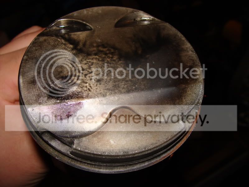

how bought some pics of destruction lol

holy ****, tell Zach, its time for some

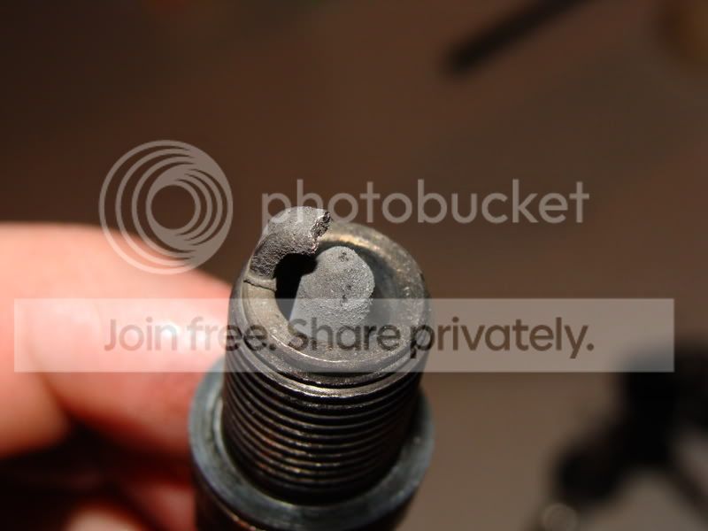

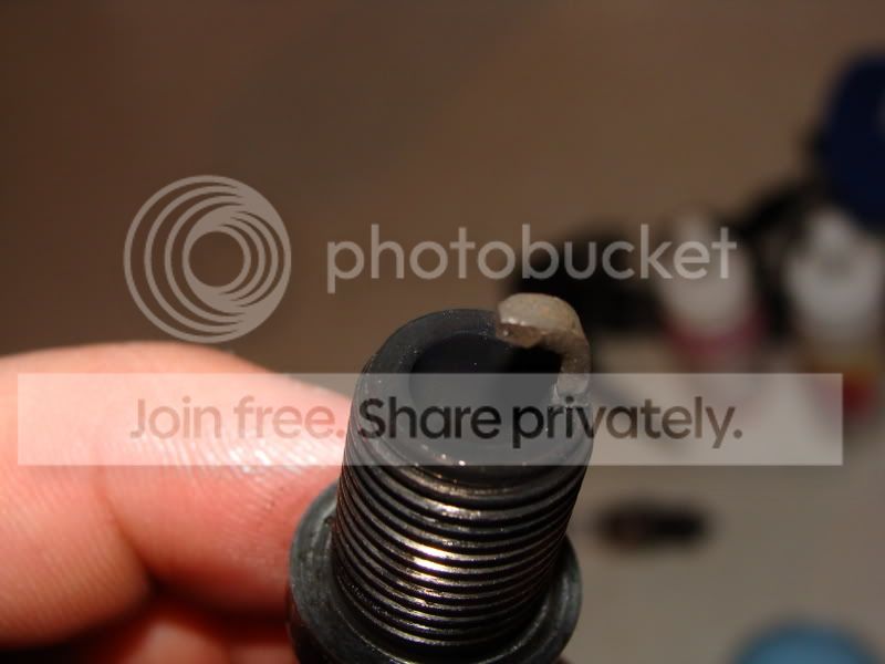

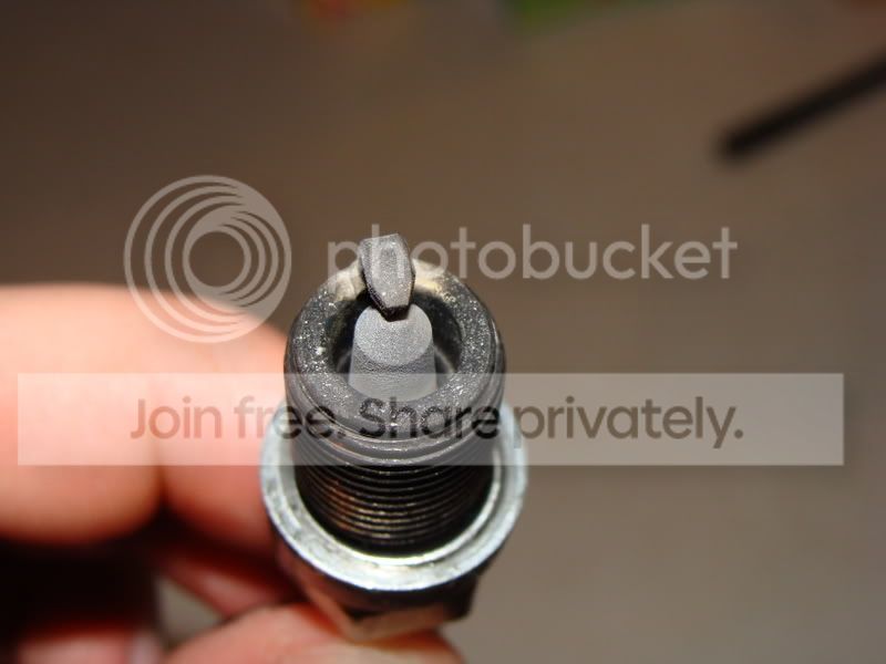

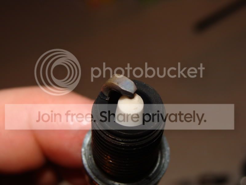

<TABLE WIDTH="90%" CELLSPACING=0 CELLPADDING=0 ALIGN=CENTER><TR><TD>Quote, originally posted by reaction360 &raquo;</TD></TR><TR><TD CLASS="quote">holy ****, tell Zach, its time for some </TD></TR></TABLE>zack doesnt need any beer is is already goofy enough without it...can you believe he pulled the plugs out looking like that and thought he could just change them and be good again lol

<TABLE WIDTH="90%" CELLSPACING=0 CELLPADDING=0 ALIGN=CENTER><TR><TD>Quote, originally posted by reactiondc2 &raquo;</TD></TR><TR><TD CLASS="quote">zack doesnt need any beer is is already goofy enough without it...can you believe he pulled the plugs out looking like that and thought he could just change them and be good again lol</TD></TR></TABLE>

**** i was semi dilusional, and this is something that even i will over...</TD></TR></TABLE>haha yea right ill believe it when i see it...after working on it the other night even i had to drink a beer and sit back...you are the owner and wouldnt touch the beer haha

So what was the cause? What kind of plugs are those?

<TABLE WIDTH="90%" CELLSPACING=0 CELLPADDING=0 ALIGN=CENTER><TR><TD>Quote, originally posted by tony1 &raquo;</TD></TR><TR><TD CLASS="quote">So what was the cause? What kind of plugs are those?</TD></TR></TABLE>im think lack of fuel is the cause,failing pump maybe....the plugs were bosch i told the owner to get some ngk 8 or 9 range plugs and he came up with some bosch platinums that cross referenced to an ngk 6,stock plugs were a 7....since i was at work during the tune,i didnt even know about the plug situation untill after the engine died...how much of a factor do you think it may have played?

A 6 heat range plug at that power level on pump has could have definitely played a part.
For the power level it was making at that boost level on pump gas, i'm sure it had a lot of timing as well, probably another huge factor. It was definitely detonation that killed it.

For the power level it was making at that boost level on pump gas, i'm sure it had a lot of timing as well, probably another huge factor. It was definitely detonation that killed it. </TD></TR></TABLE>the thing about the timing is...the base map that was used for this car was taken from a yellow s2k that full-race built and you tuned...i believe the timing map was untouched from whatever you set it at on the yellow car...im not sure how much differently the timing should have been set since this was a 10.0:1 motor with a log manifold and a smaller turbo compared to the low compression,tubular manifold 35r powered full-race s2k...would you think the timing may have to be changed drastically between the two different setups?

I heard there was significantly more ignition timing on that car than the yellow one.
And a log manifold makes a HUGE difference in the knock limit on those engines.
The tune between those two cars should be VERY different.

#6 plugs, base map and kaboom. Why spend all that time and money to kill it?

The tune between those two cars should be VERY different.</TD></TR></TABLE>i think the tuner basically took your map and adjusted the afr's and then charged the poor owner $700+...i really dont think the tuner did anything to the timing maps but we will see once we are able to pull it up on the computer..once im able to get it ill try to post it for some tuners to look at

#6 plugs, base map and kaboom. Why spend all that time and money to kill it? </TD></TR></TABLE>it wasnt a base map...it was "professionally tuned"

Chris called me and asked me about the ign. timing, he said there was about 7 more deg. of timing than his map had in boost.
Who "tuned" it?
