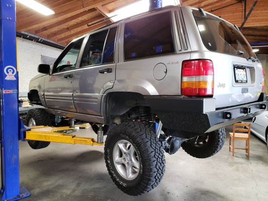

Thanks, will keep you guys updated. Lol not much to show yet, bone stock 89 crx hf with rpf1's and yokohama a048's hahaha. My uncle kicked me out of our shop because we argued over late pay so he fired me (illegal I know but whatever) lol not comfortable doing a swap at the new shop I'm at now so will just pay the $1,500 or so during the winter to have the swap done. Have ex knuckles and rear disc conversion ready to go on, larger booster and MC. Getting my dealers license is my first priority, then jeep and then crx. Was debating going with an LSV but smog is a pain here in CA. Don't want to go obd2, so my choices are either b16 or h22. Found a prelude for cheap, smogged and registered.
The jeep is a sleeper too lol I know there's some jeep guys here on ht don't remember who but it's a 98 5.9 zj grand cherokee. I have around 5k in performance stuff to throw on. Have been holding off but my water pump started leaking so I need to get on it asap. Lightly ported heads, cam, intake manifold, headers, rockers, lifters, pushrods, tuning, injectors, timing chain, throttle body, etc. Suspension is all IRO long arms, 6" lift, OTK steering, PSE steering gear, bilsteins on (only) 32's until I can afford some killer axles (around 8k). Should net 425hp 475tq with a nice lope at idle, when the 5.9 dies I'll go 6.7 stroker with a new cam, maybe 475hp 525tq Few cars are quicker to 30mph haha, leave the first few feet with the front left and rear right spinning. Have hurt STI and mustang owner feelings in the past lol.

The 98 5.9s are bad ***. I got the chance to tune a 07 srt8 Jeep on a 125 shot. That suv hauled ***. Crx looks clean man!

Thanks, I bought it with no real intention of off roading. Pure Bay Area assault vehicle. 6" of up-travel 5" of droop with the lowest spring rates out there, to hit these speed bumps and curbs full speed lol curbs tested at 25mph speed bumps 40mph catching air. Stuck in the middle of red/black traffic in google maps with no way out? No problem, lock wheel to the left and punch it. Goes over all kinds of dividers and bushes just great! Metal bumpers so even the most determined old lady in a subaru forester won't make a dent trying to fit in a space too small. Oh, and no one ever wants to park too close to me lol so my fat *** can always get in and out anywhere I go. Ride so high I can see a dirty pedestrian ready to jump out in front of me from a mile away, single 3" straight pipe after cat, leave their ears ringing and eyes burning from teh emissions of my sct flash. Lol and road rage? Never an issue in the niner haha. Miss driving it..
