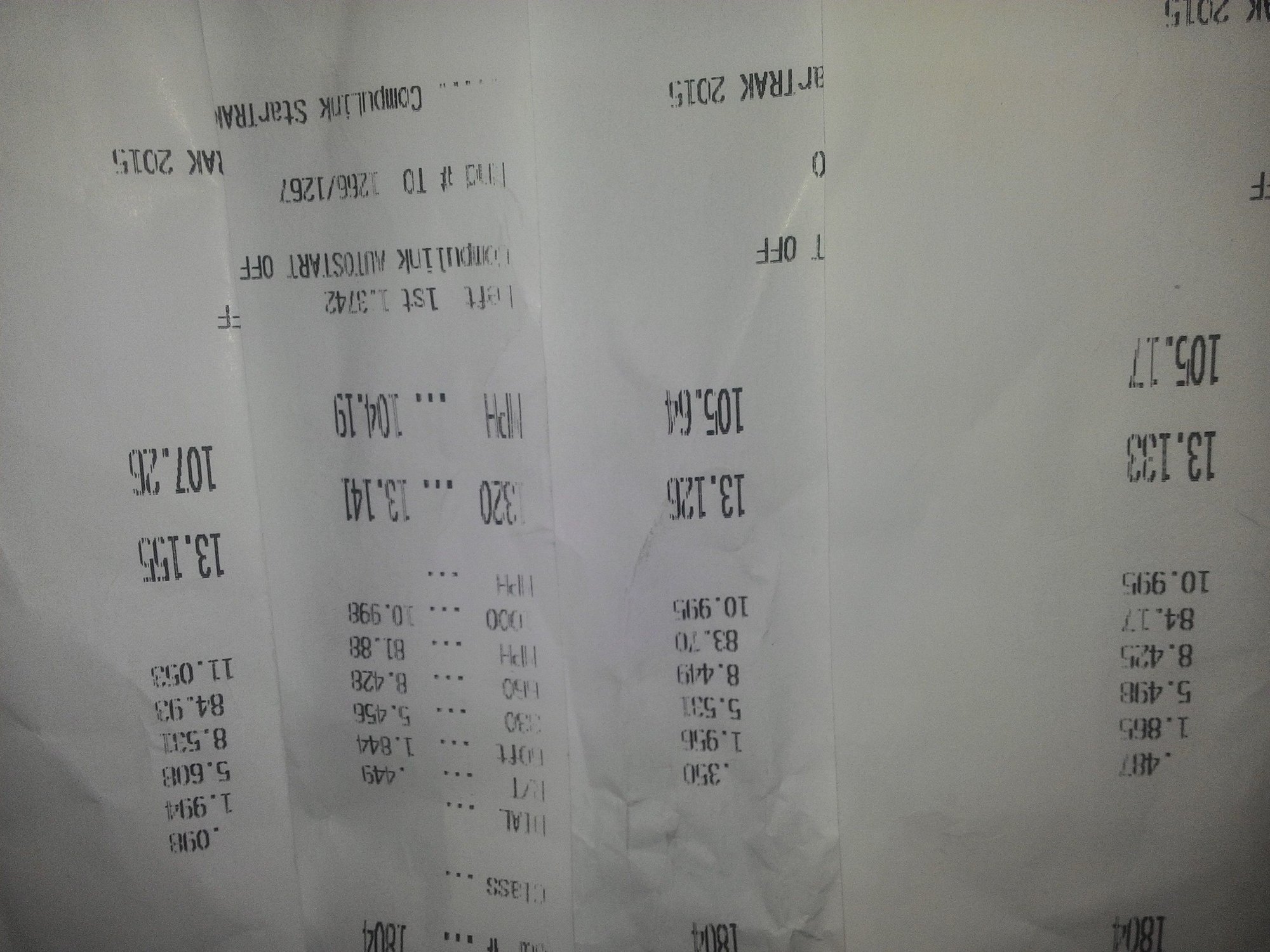

small update if it matters to anyone new 38mm tail diaphram was installed running the ebc as pictured above. made it much nice to tune. got tune squared away.
went 13.1 two weeks ago track sucked could launch harder then 5800rpm.
going to rent dyno once the weather here clears up so i can tune timing hope to have numbers soon and will post in the ls-t page. thanks for everyones help.
