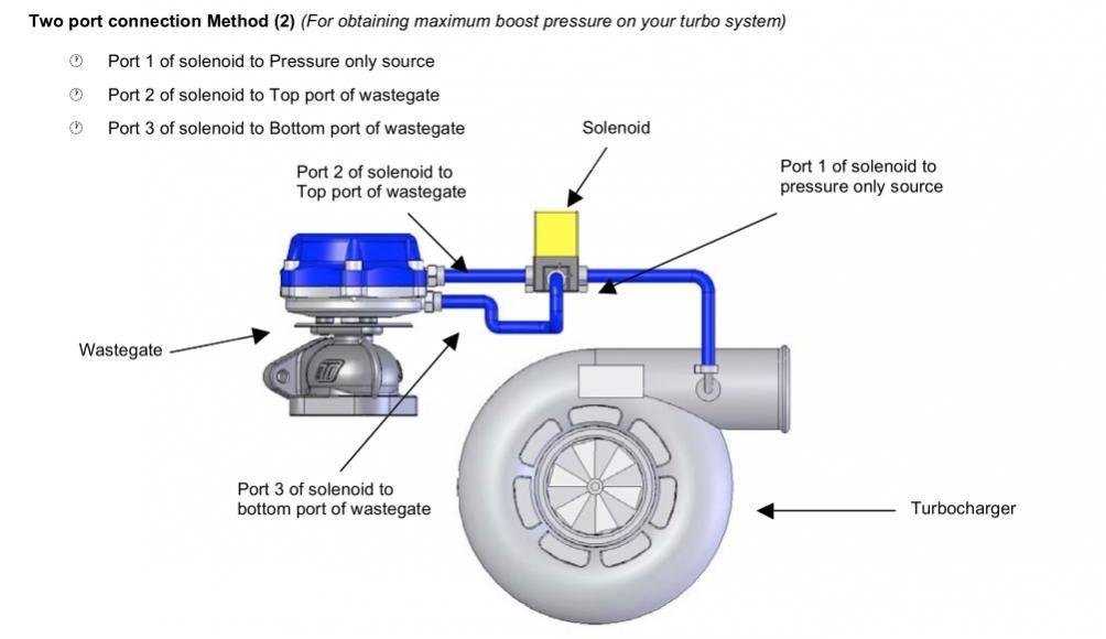

Originally Posted by 96ekb20
when i bought this ebc it didnt come with a diagram of how it was to be hooked up. so i looked online and everying i found for extrenal gates is port 1 gets boost source and then t's over to bottom port of the gate. port2 goes to the top of the gate. port 3 vents? sound about right ?
Not having paper instructions in an effort to save costs and trees is more and more common with the IOT of things.
Just post the link of the image diagram you found to best validate what you believe is the correct hook up. Then post a photo of your engine bay to help visualize what you think is correct.
Old Feb 19, 2016 | 09:47 AM
  #70
96ekb20's Avatar
Joined: Sep 2015
Posts: 429
Default Re: super crazy over boost problem!!!!!!!
this is how i was going to hook it up. will post pics of my ebc silinoid later wen i take it off.
That's fine, but you may want to take the line that goes to the compressor cover and put that via the intake manifold.

  #73
96ekb20's Avatar
Joined: Sep 2015
Posts: 429
whats the different effect that will have?
A more stable vacuum point.. Lessens chance of creep or unstable boost reference
