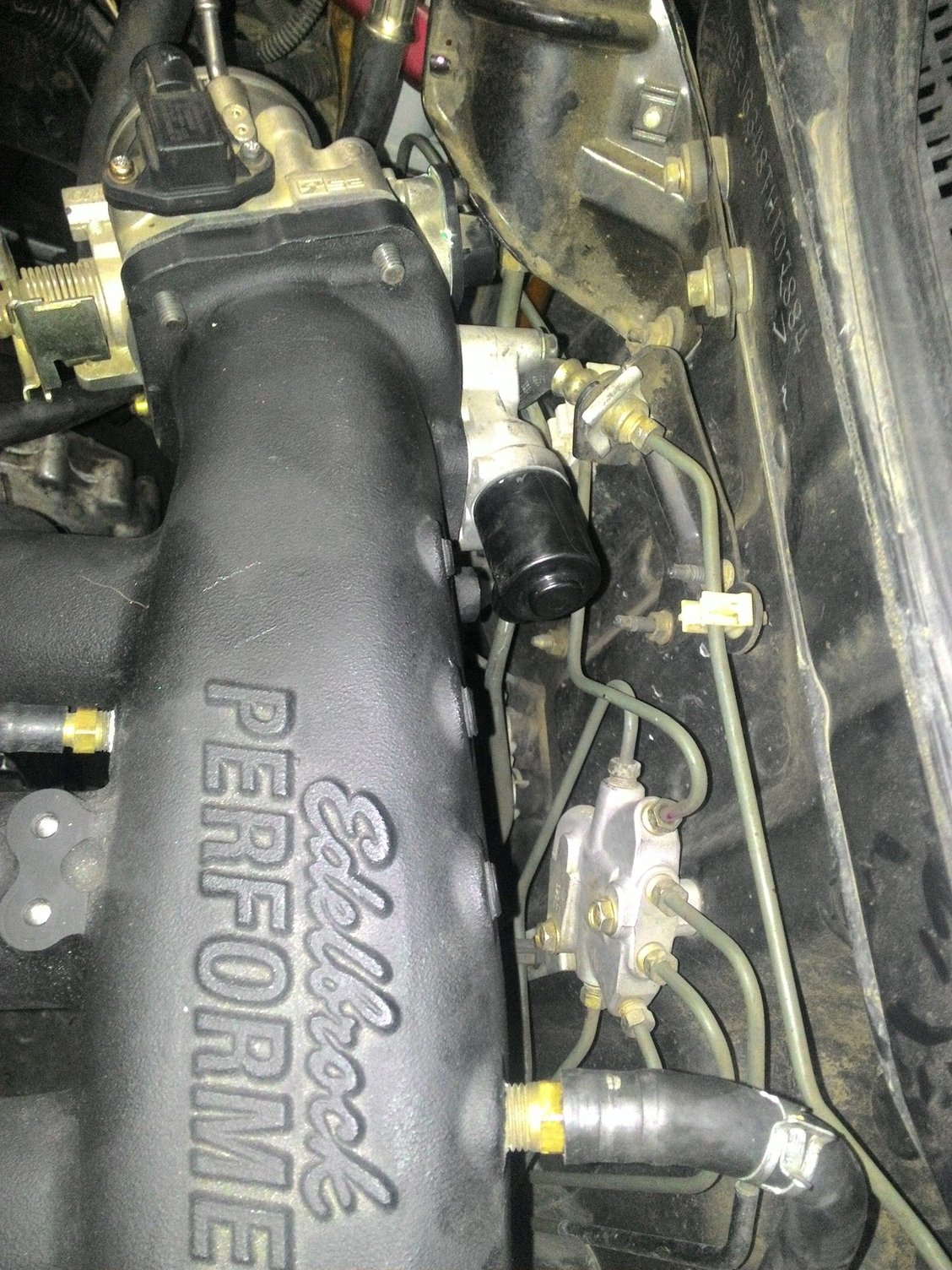

oh and the gm map sensor is using its own vacuum port off the intake i have a prototype performer x intake manifold which has alot of ports for vacuum nipples to be put in.

this is when i was mocking things up<br/>

as you can see there alot of ports i can use this it where i ran the gm map sensor too.
