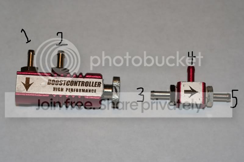

I need help hooking up this MBC. These are the two parts that were included and I want to know if any one has used a similar MBC. I dont know what the "T" part is but I hooked the left part up both ways, between my compressor housing and the waste gate and I hit the boost cut both times. I have a 1/2 bar spring so somebody tell me how to hook this up please!!!
I numbered the ports to make explaination easier.

ok just to help you out i will give it a try... once again a TRY
#1- from vacuum source
#2- to waste gate
#3/4/5 looks to be a T to T off of a vacuum source if you have a vacuum manifold just use that and don't worry about using the T.
If you do use the T
#3- from vacuum source
#5- to the other side of the vacuum source
#4- to the waste gate
hope this helps. i am in the middle of building my kit now and have done research for the past year or so... that is what i THINK. I don't KNOW. so don't get all pissed off if I'm wrong. hopefully someone else can Post to help out.

the block(on the right in your picture) with the arrow goes in line to your wastegate(#3 and #5) the arrow points toward the wastegate(as per the instructions on the side of the block).
take a vacuum line from #4 to Number #1 on the controller
#2 is a bleed it stays open

yea thats the incabin style. One of the nipples on the controller like he sais just vents back to the engine bay. Its pretty nice.

So it should be something like this if I'm using the port on my turbo as a pressure source, right? It's weird though, if I blow into port 3 air barely passed but port 4 and 5 flow freely.

yea that should be right. Maybe something is clogged up in there. Is it used?

Nope not used, but if it is clogged I can always take it apart, it looks simple enough. So I can mount the MBC in the cab of the car? Thats cool.

looks like a basic dual stage controller, these guys semm to have u covered

http://www.turbosmart.com.au/index.php?id=43
its a knock-off turbosmart boost controller.
i had one but it had different stickers on it so im sure it was from a different seller.
tip: keep an eye on the boost gauge, mine had horrible boost creep. its now in the trash.
hope you have better luck.
