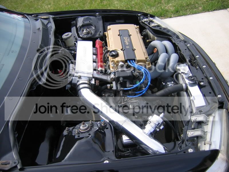

I am trying to decide on what new turbo to get. I am currently running a turbonetics t3/t4 60 trim turbo but its really worn out so its time for something new. I made 439 whp and 305 torque @ 19 psi with this turbo... i'm trying to get something that will peak out at around 500 ish whp and be really good for around 400 whp on the street. Just wondering what you guys would suggest.
Setup 81.5 mm 9:1 compression gsr motor
Thanks ahead of time
Old May 20, 2008 | 08:13 AM
acrocat's Avatar
Posts: 1,229
From: De Pere, WI
Here are two i was thinking of.... SC61, gt35r.... any other suggestions or oppinions would be great... i would like to order a new turbo by the end of the week
