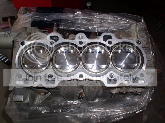

Hey guy debating what turbo i should get for my new set-up
9.2:1 JE pistons and rings
Arp rod and head bolts
Blue printed hotanked b18a1 block and head
stock rods and crank
Ferrea valves
crower dual valve springs, t-retainers and turbo cams
new valve seals
honda bearings
oem type-r timing belt oil and water pump
blox intake manifold
hondata s200
Im shooting for 250whp im puting it in my new 90 CRX si.
What turbo do you think i should run? Im posting up some pics this weekend. looking to spend around 1,100.
