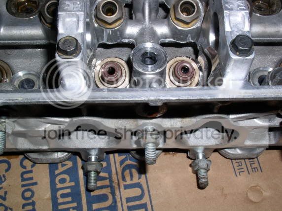

Old Apr 4, 2006 | 06:45 PM
b20vtechatch
Guest
Posts: n/a
Default Re: b18a1 boost project (b20vtechatch)
some pics

yes i did it all my self minus the machine work. this is my third build. im doing this one for a daily driver for fun. i think 275ish would be fun in a crx. ill post some more pics im going to run n/a till summer. i have a 4-1 header aem cold air for now and im also using th ls cams for now.

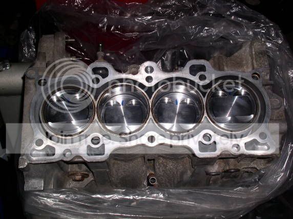

it might just be the pics but are the pistons in backwards? the valve reliefs look a little bigger on the exhaust side in the pics. correct me if im wrong im blind haha

YOUR BLIND I EVEN MARKED THE INTAKE ONES WITH "I".

Default Re: (AllmotorEH2)
<TABLE WIDTH="90%" CELLSPACING=0 CELLPADDING=0 ALIGN=CENTER><TR><TD>Quote, originally posted by AllmotorEH2 &raquo;</TD></TR><TR><TD CLASS="quote">it might just be the pics but are the pistons in backwards? the valve reliefs look a little bigger on the exhaust side in the pics. correct me if im wrong im blind haha</TD></TR></TABLE>
Yea thats exactly what i thought. Must be an optical illusion

<TABLE WIDTH="90%" CELLSPACING=0 CELLPADDING=0 ALIGN=CENTER><TR><TD>Quote, originally posted by b20vtechatch &raquo;</TD></TR><TR><TD CLASS="quote">
You are 100% sure those are the intakes on the back? Because it reallly looks differently from this picture.

100% SURE. I know it looks that way, but its the way the picture came out. Thanks for the lookout though.

Default Re: b18a1 boost project (PrecisionH23a)
Im pretty positive that theyre backwards man. If you look at the space between the reliefs on the "exhaust" side youll see that theyre alot closer than the "intake" side. Measure the reliefs on both sides and post them up...then ill be able to tell you if theyre really backwards or if its an optical illusion.
BTW-Im not trying to bust your *****. Im trying to help save you from a blown motor and most likely a ruined head. I know how it feels to blow a motor because of a little expletive up. Good luck man

<TABLE WIDTH="90%" CELLSPACING=0 CELLPADDING=0 ALIGN=CENTER><TR><TD>Quote, originally posted by b20vtechatch &raquo;</TD></TR><TR><TD CLASS="quote">100% SURE. I know it looks that way, but its the way the picture came out. Thanks for the lookout though.</TD></TR></TABLE>
I'm about 100% sure they are in wrong. You don't want to damage that nice valve-train now do you? Go ahead and slap in a set of rods in there while you are changing the pistons around.
I'm also not trying to bust your *****... just trying to help out.
Third build, huh? Did you put the pistons in backwards in those two also?
The bigger reliefs are for the LARGER intake valves.
Also, I hope those rod caps are already broken loose. Most builders put the crank in before the pistons/rods.

Pistons ARE in backwards and get a T3/T4!!!!!!!!

they are not backwards! i ****** checked them and they arent backwards its an optical illusion from the flash of the camera. in person you can tell they are right. my machinest wouldnt do such a thing. stop saying they are backwards. END THIS TOPIC I ASKED A TURBO QUESTION AND YOU GUYS ARE TALKING ABOUT MY PISTONS. I KNOW YOU GUYS ARE JUST TRYING TO HELP BUT I TOLD YOU THREE TIMES IM 100% POSITIVE THEY ARE ON RIGHT!!!!!!!!!!!!!!!!!!!!!!!!!!!!!!!!!!!!!!!!!!!!! !!!!!!!!!!!!!!!!!!!!!!!!!!!!!!
