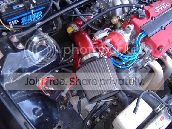

UPDATE: (October 19, 2006):
So far, I've been running this distributor for 6 months and approximately 7500 miles. I took it apart for inspection and everything looks normal
That's good news after seeing what happened to DrVtec99's unit, but it does pay off to retorque and reinstall all the fasteners and bolts before installing the distributor. I also gave a small dab gasket sealant on the distributor-to-head O-ring and it has been leak-free since the day I've installed it. I used to replace my plugs every 3 oil changes, if not, I get a very precise "time-frame" as the engine will soon misfire if I neglect the plugs. But this time, my plugs should have been worn out already yet I have no signs of misfire yet. I am on my 6th oil change and these plugs are still doing their job which is a sign of better spark compared to OEM dizzy with external coil
On the other hand, I went full stealth again for my engine bay. After a recent encounter with a traffic cop and giving me a lot of trouble from all the "shiny stuff", I've decided to hide everything "easily noticeable"... Most people will think my engine is pretty much stock unless it was from a trained set of eyes. Here is what my engine bay looks like now (yes, I know it sucks to paint the MSD dizzy):

<TABLE WIDTH="90%" CELLSPACING=0 CELLPADDING=0 ALIGN=CENTER><TR><TD>Quote, originally posted by Tony the Tiger »</TD></TR><TR><TD CLASS="quote">UPDATE: (October 19, 2006):
