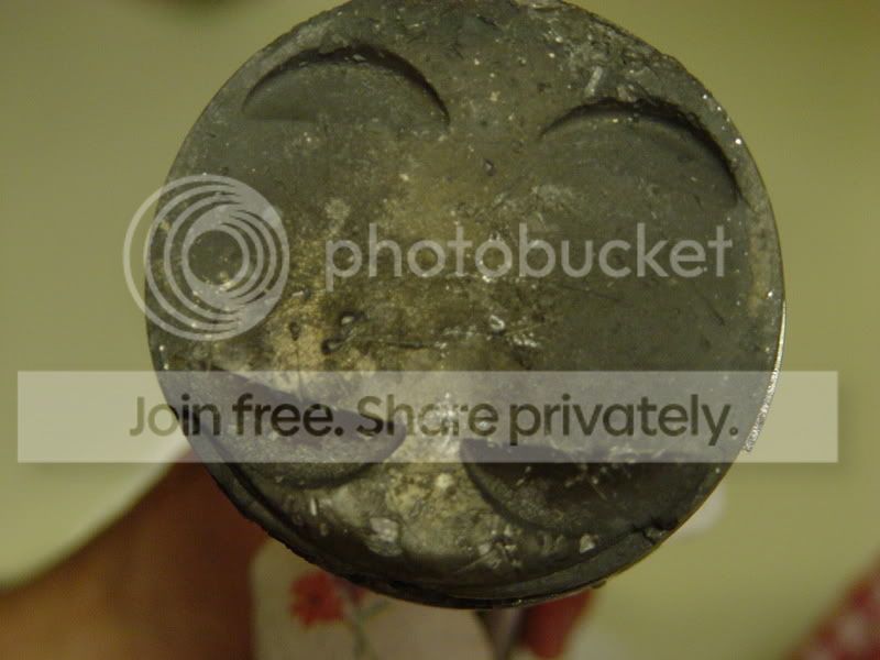

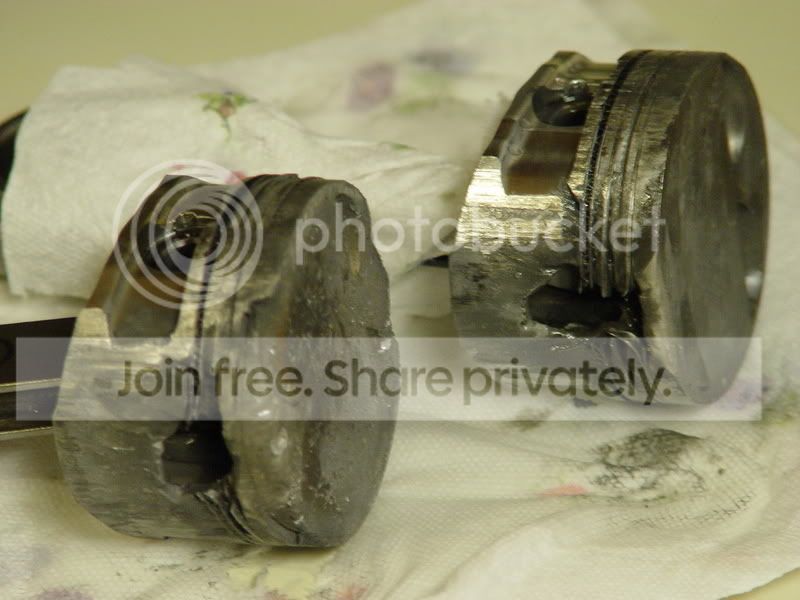

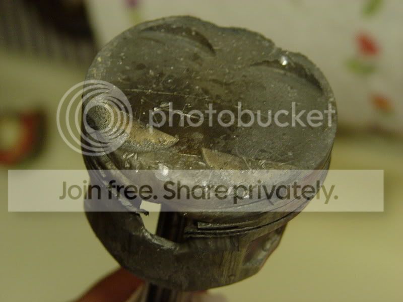

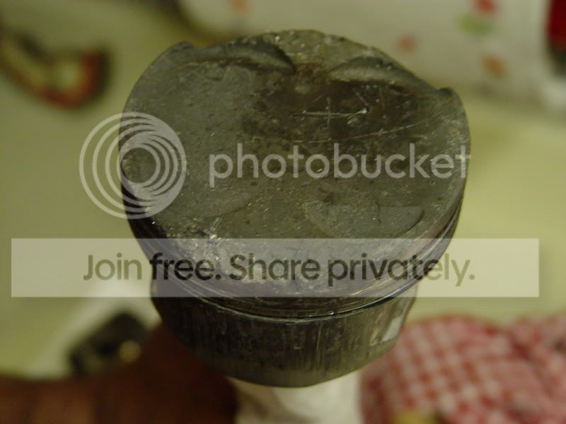

bump for some pics, got around to taking that **** apart last night.

i took the cap off of 3, and that **** just FELL OUT. I didnt have to push or tap or nothing. number 4 DID NOT want to come out.

any idea what would make the intake side crumple on #4? I would think that the exhaust side would take the most beating. Or could the detonation have taken out the intake side?
