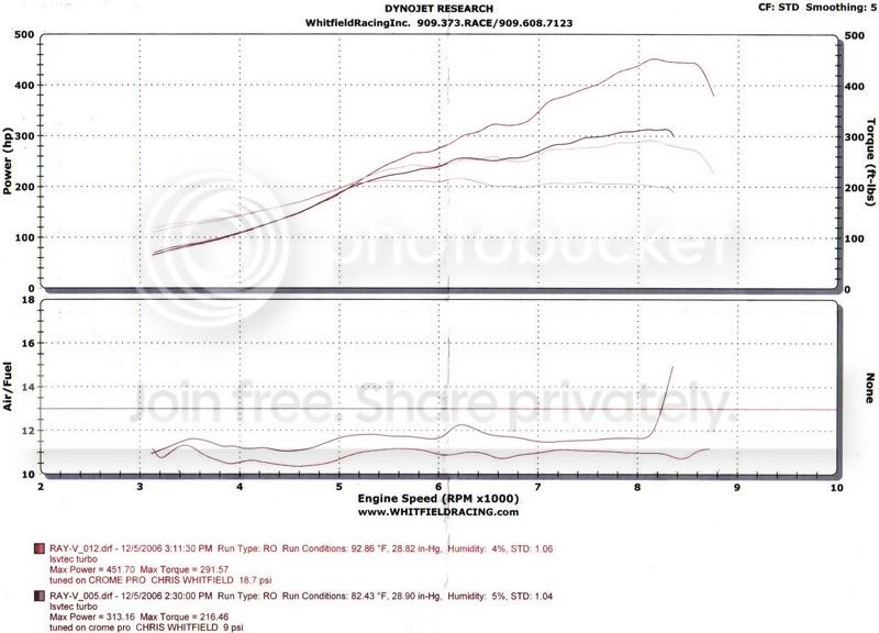

This is the new setup for my boy Rays Integra. Pretty happy for what we have.
LS Block w/ Darton Sleeves
Probe 8.8 comp 84mm pistons
LNB Rods
Stock Crank
Stock Head gasket
B16 head (stock)
Gude Perofrmance Regind b16 Turbo Cams
Super Tech Valve Springs & Retainers(Thanks Earl Laskey)
Type R Mainfold
T3/T4 Inovative Turbo
Whitfield Racing Custom Exhaust Manifold
3" Exhaust
Tuned On Crome Pro by Chris Whitfield
Thanks again Chris for a great tune. One chip for daily driven on pump gas and one for track use. Once again you hooked us up.

good stuff. what turbo is that? and y did u stop at only 18psi. u got a sleeved block, i woulda turned the boost up and pushed over 500whp with that setup

this car can easily make over 500 whp ... this was tuned through a full exhaust with a muffler.. open downpipe will probaly gain 20hp

Don't take this the wrong way (just trying to help):
What kind of fuel was used ?
It looks like your boost is creeping according to your dyno sheet.
When does the setup make full boost in 3rd or 4th gear ?
Why is your a/f ratio in the high 10s up to 5k ?
What was your a/f ratio at 6.5k ?
Did anything wierd happen at 6.5k, the dip on the map just looks a little wierd to me

The first tune was done on 91 octane pump. These numbers are on the bottom of the sheet. The second tune was done on C16. He wanted two programs for street use with pump gas and one for track use with race gas.

<TABLE WIDTH="90%" CELLSPACING=0 CELLPADDING=0 ALIGN=CENTER><TR><TD>Quote, originally posted by mtber &raquo;</TD></TR><TR><TD CLASS="quote">Don't take this the wrong way (just trying to help):
Did anything wierd happen at 6.5k, the dip on the map just looks a little wierd to me </TD></TR></TABLE> well to answer your question john ... this is thie first time that i have tuned this vehicle ... and this vehicle has had 5 different motors in it in the past couple of years all blown up due to impropper tuning (lean) this customer specifically asked me to do a VERY safe ,Rich tune so that the motor would last. as far as what happened at 6.4-6.5 i believe on this run the car actually spun the tires right after it hit vtec (6100).

at that power level. why was race gas even used?

that A/F looks like it was just street tuned...

I can understand wanting to be safe but high 10's would not be considered an ideal a/f ratio.
Vtec was at 6100 on a stock b16 head... why ?
(This is unusually high for this kind of setup)
What gear where you making the pulls in ?
If you look at the graph there is still a dip on the pump gas tune at the same rpm level this indicates that the issue is not the tires spinning.

Good point john good eyes as I said this is the 1st tune on a brand new motor and I was asked repeatedly to do a rich safe tune. This car runs hella strong and the customer is very pleased... I believe that I will be retuning this car very soon we are gonna shoot for 550ish. Should be fun. Ohh and john vtec was set at 6000 bexause he had some gude(bullfrog) custom grind cams.... U and I both know that on stock b16 cams we would normally turn them on at 5k or so...well in turbo cases about 4.5k
