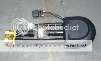

COBB Tuning - Mitsubishi 3 port solenoid actuators, looks a LOT like a MAC upper casing

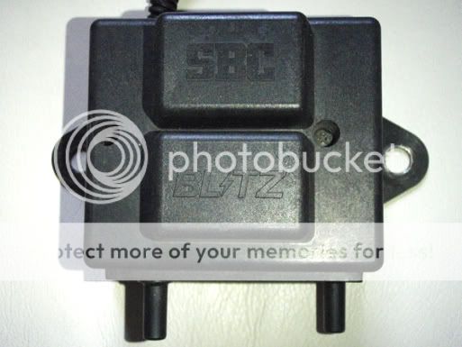

Blitz SBC Series - Spec S used a Single (Toyota-Denso)? Automotive solenoid, SBC ID had twin Denso solenoids in a different package
Dual Denso Solenoid
Single OEM Toyota/Denso Solenoid
