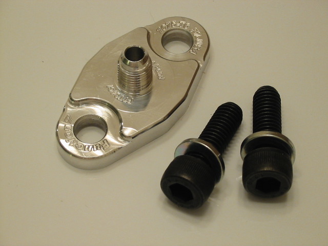

Here is the oil inlet flange too:
http://cgi.ebay.com/ebaymotors...68954
Function7 T3/T4 -3 AN Turbo Oil Inlet Fitting
Function7 - Precision Machined, 7075 Billet Aluminum, -3 AN (JIC) male inlet fitting
P/N F7T34CI
This is a fixed price sale for a one-piece billet T3/T4 Turbo Oil Drain Flange with a male -3 AN (JIC) flare fitting machined directly onto the flange. Like all Function7 products, these fittings are precision machined out of the strongest, airframe grade 7075 aluminum, and is 18-20% stronger than 6061 grade aluminum.
The fitting on this flange comforms to ISO 8434-2/SAE J514/MIL-F 5509 standards will work with any standard -3 AN hose end. No other adapters or fittings will be required.
The Function7 patented design also gives additional strength to the flange while allowing better heat disssipation from the turbo, allowing it to run slightly cooler and prolonging the life of the turbocharger bearings. These flanges are also designed to be self sealing without a gasket to further improve the heat transfer charactreristics so no gaskets are included.
Two allen (hex) bolts (M8 x 1.25mm) with matching lock washers will be included with every flange. Please contact us if you require -4 AN sized or larger fittings.
This fitting work on the following turbochargers:
T3 Series Turbo
T4 Series Turbo
T04B Series Turbo
T04E Series Turbo
Hybrid T3/T4 Turbo
