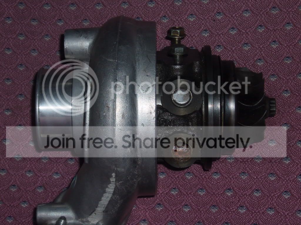

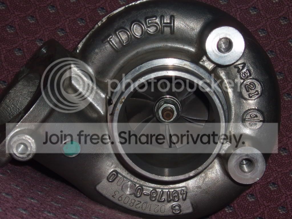

MR2 turbo? Or Greddy? thats the two i was told it was.
1. How much is this worth?
2. Is this a reliable turbo?
3. Where can i get the exhuast side to this turbo?
4. Is it a T3 or T4 turbo?

where is the other housing? lol

uhhh....it's a MHI TD05H
get the hotside off a td05 dsm turbo, worth about 100 bucks, very reliable, mitsu flange - not t3 or t4

yeah, where is it? where can i get it? <TABLE WIDTH="90%" CELLSPACING=0 CELLPADDING=0 ALIGN=CENTER><TR><TD>Quote, originally posted by DAslammed &raquo;</TD></TR><TR><TD CLASS="quote">MR2 turbo? Or Greddy? thats the two i was told it was.

compressor wheel appears to be at least a 16g if not bigger. find a 7cm or larger exhaust housing then rock it. about a 300hp turbo assuming it is a 16g and if you got 7cm+housing.
