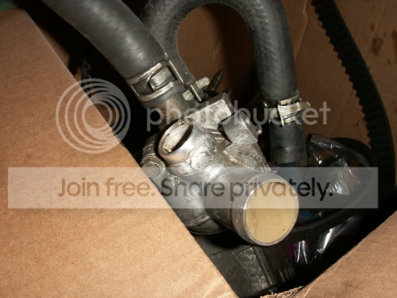

just weld a bung in the water neck or thermostat housing or something...looks way better

<TABLE WIDTH="90%" CELLSPACING=0 CELLPADDING=0 ALIGN=CENTER><TR><TD>Quote, originally posted by Turbo-charged &raquo;</TD></TR><TR><TD CLASS="quote">just weld a bung in the water neck or thermostat housing or something...looks way better</TD></TR></TABLE>
Does anyone have any pictures of doing it this way?
Thanks

not the best picture in the world...but a bung on the thermostat housing

Default Re: (Turbo-charged)
thanks for the pic man. I think i might give that a try!!!
