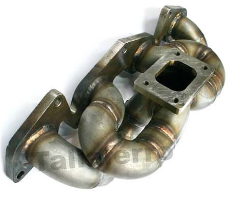

i saw this thread. many differencies between these manifold..
thanks for this info.
BUT with the word topmount i didnt mean this huge manifold.
i mean something like this one
i will try to do my best at midle with the turbo..and in 3-4 months
i will go with sleeves to make something better..

Re: help me to choose dimension for turbo manifold
I'm not tired, but it seems as though you're trying to use the wrong information to try and get what you want anyway.. Unfortunately it won't work.
Look at that manifold link and read it carefully they go through charts, graphs, fluid dynamics, everything. Top mounts are made for larger turbos in bays that lack any room, since the turbos mainly used are for top end, large CFM turbochargers that don't want to worry about "spool" or "response" or anything that shows the characteristics that a GTX3076R was made to do. If anything, you'd be doing yourself a dis-service in doing it that way.
If you have the means to make your own, then you have means to know what materials to get and which lengths are needed. This is where the fabrication forum can help and not here. If you don't know what you need by way of lengths, materials and schedule 10 steel needed.. then no, you CAN'T build your own like them. Unfortunately, because there are many people who make these for a living to feed their family, they will not attempt to create a write-up of exactly what's needed and how, just so you can make your own.. It may not seem fair, but it is the way its done in American culture.
Here are the "styles" you want to emulate.
"Quick4 or Quick4AC"
Kook-designed "Ramhorn"
AFI-Bottom-mount
You can change manifolds (be it made, or purchased), get the right management, proper crankcase ventilation with a catchcan, and at least 880cc injectors, you'll be ok..
