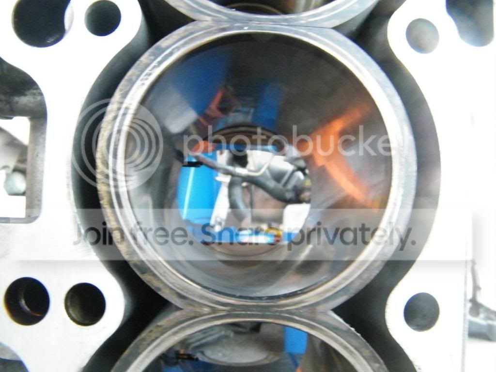

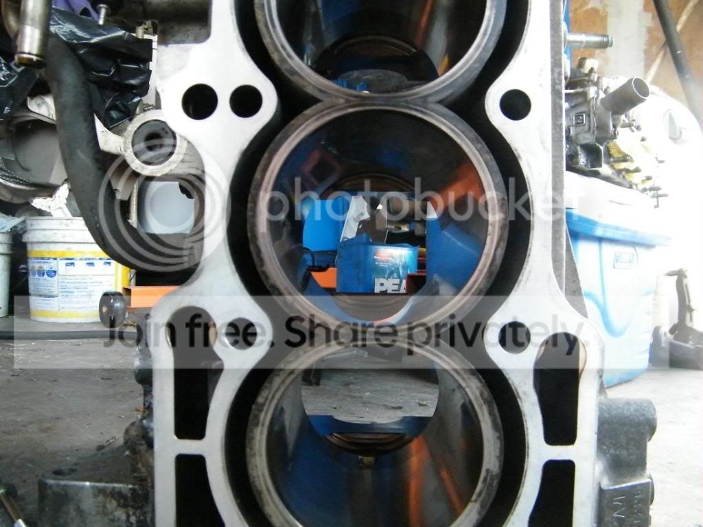

My friend and I are seriously interested in picking up this block, but I'm not sure if it's sleeved (said it was Darton sleeves, but didn't specify what kind) or not since I've never seen stock H-series sleeves. I'm quite positive that it is sleeved though since I can clearly see the separation lines between each cylinder. I know that's how it is for sleeved B-series, just not sure for H-series.
I just need some reassurance before my friend and I make the trip to check out and pick up this block.
Here are a couple of pictures:
Please let me know.
TIA!

Id say no.

Its a open deck style sleeve. Benson and RS machine are the only companies I can think of that do a open deck. You can tell there not stock as there is that little line in between the each cylinder.

yup

sleeved by the witness line in the middle. looks like GE econosleeve

Yes that is a sleeved open deck style block.

Thanks guys, that's all I needed to know

also, if it were stock sleeves, the walls would be a light grey.

sleeved, but it may be press in liners

i have a GE sleeved open deck h22 they look different... GE also incorporates a block gaurd with their sleeves on an open deck h22... look at my sig (2nd page). like previously stated maybe a press in liner.
