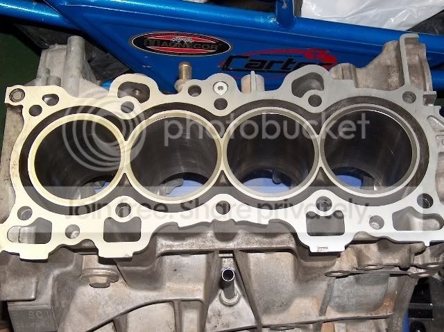

is this block sleeved????
Old Oct 20, 2007 | 04:40 PM
laziebun's Avatar
Posts: 909
From: Central IL
Default is this block sleeved????

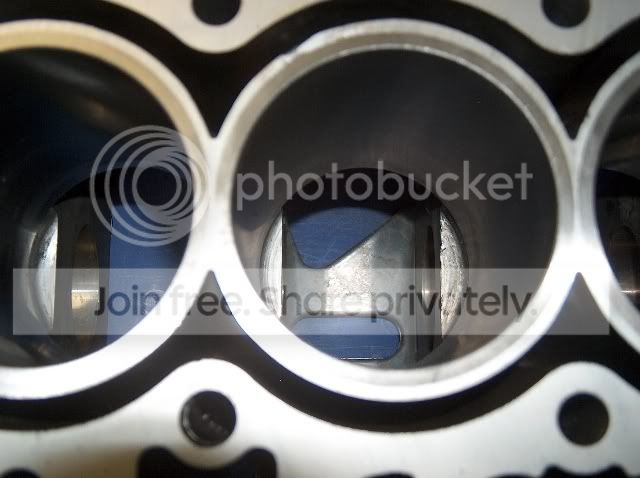

is this block sleeved??? seller says it the same sleeve JG uses in there motors
and the 3rd cylinder has a knick anyone think it might have a problem any effect on the blocks performance under boost?
Old Oct 20, 2007 | 05:09 PM
SD_Lurker's Avatar
HT White Ops
iTrader: (4)
Posts: 6,116
From: Ova Thur, United States
Default Re: is this block sleeved???? (laziebun)
looks like stock sleeves to me.

Old Oct 20, 2007 | 06:31 PM
kshgl87's Avatar
Posts: 130
unless im a total noob, how would they install all 4 sleeves in one piece? you can see they are all attached like stock sleeves
Old Oct 20, 2007 | 07:36 PM
SlowReaction's Avatar
Posts: 953
From: Wa
Default Re: (kshgl87)
I dont know what you would define as sleeves? Those are you just new thicker replacement sleeves. A lot thicker then stock. What are you plans for the block? I wouldnt expect to push 800hp or anything but its a good all motor block. I'm sure that block could take a 85mm bore.

Old Oct 20, 2007 | 11:49 PM
Posts: 953
From: Wa
Default Re: is this block sleeved???? (redline32)
For all those guys claiming it stock, I can tell you've never took a head off a bseries engine before.
Here a picture a stock bseries block. Look at the distance between the iron sleeves in the first picture and the the one I just posted
Modified by SlowReaction at 1:25 AM 10/21/2007

Old Oct 20, 2007 | 11:58 PM
kshgl87's Avatar
Posts: 130
they dont look any thicker to me but then again its a picture. looks like the block was decked though because you can see a very definite seperation of the metals
Old Oct 21, 2007 | 12:08 AM
redline32's Avatar
Posts: 249
From: ohio
you can see that same seperation once you clean the head surface for a new head gasket, allmost all aftermaket sleeves are individually pressed in. the picture shows one piece aluminum stock sleeve
Old Oct 21, 2007 | 12:14 AM
Posts: 953
From: Wa
added picture on my post. I'm not a sleeve expert haha but you can clearly tell if you looked at a normal block that the one he posted is not stock

Old Oct 21, 2007 | 10:15 AM
mcaro's Avatar
Posts: 2,901
From: 36TH CHAMBERS OF DEATH, afganastan
hahaha that guy is a rip off stock stock stock
Old Oct 21, 2007 | 11:37 AM
Garage 808 Hatch's Avatar
Posts: 5,433
From: CRESWELL, Oregon, 97426
those are not stock sleeves. if you guys werent blind you could see the gap difference between the ductile iron in the 2 pics posted. the stock one has quite a bit of aluminim between the iron, and the one in the OP, has very little alum there. they just arent the solid deck "style" you all think every sleeve looks like. they bore the alum out, and press in the thicker ductile for more strength
