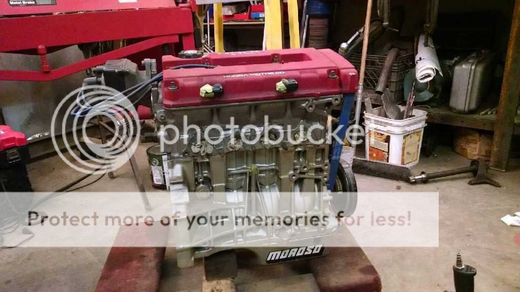

UPDATE! New Motor![b\]
-B16 Head
ITR intake cam
Peak Performace cam gears
Supertech valve springs and retainers
ARP head studs
-B16 Block 84.5 bore
Golden Eagle HD sleeves
Carrillo 1000hp rods w/ carr bolts
cp 9.7:1 pistons upgraded wrist pins
moroso 5 qt pan
complete oem gasket set
oem water/oil pump
