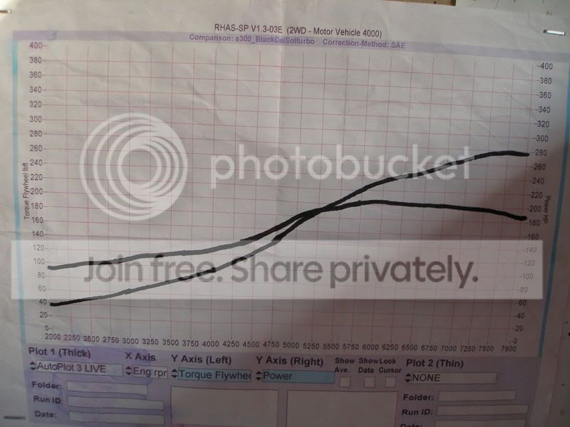

well i finally got my first turbo project done. its nothing crazy but it keeps me happy. hopefully she lasts for awhile.
huge thanks to jeff evans for the exhaust work and the tune.
below are some pics had to highlight my graph with a sharpie due to printer ink running low.
numbers
280 hp
205 tq
9lbs.

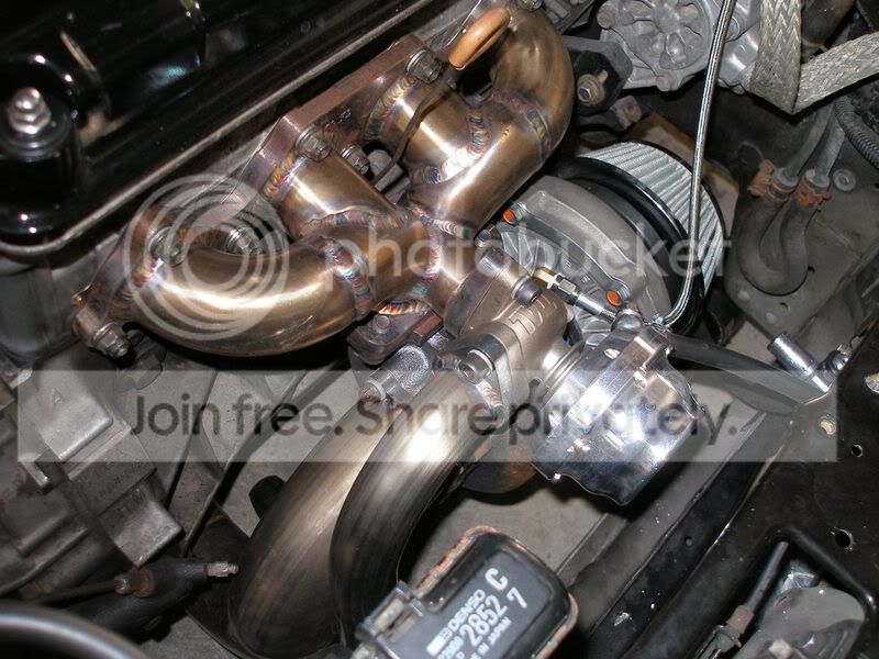

setup:
stock b16a
SLS minilog manifold
garrett 57 trim 63 ar
tial 38 wastegate
full 3'' exhaust, vibrant resonator and skunk2 muffler
turbo xs manual boost controller
2.5'' intercooler pipe
greddy rs bov
ebay intercooler
rc 550 injectors
walbro 255 fuel pump
gm 3 bar map sensor
mfactory catch can setup
oil- -3 feed, 1/2'' return, moroso pan

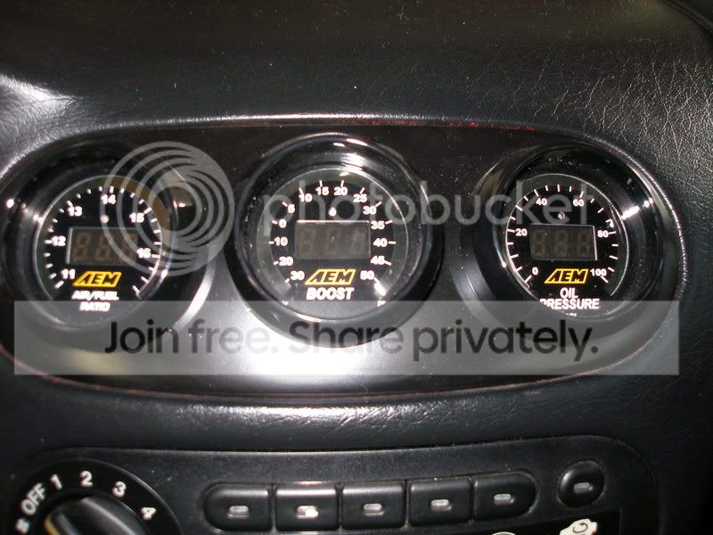

aem boost oil a/f gauges for reassurance

You sure you just hight lighted that graph or just drawn it your self? lolz ... What PSI?

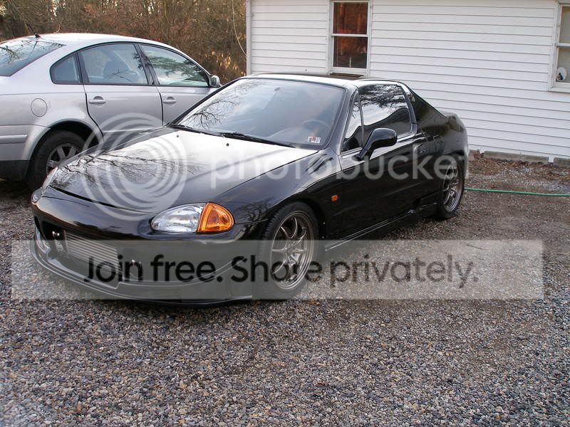

I'm not a real big fan of Del Sol's, but yours definitely looks sick. Good job

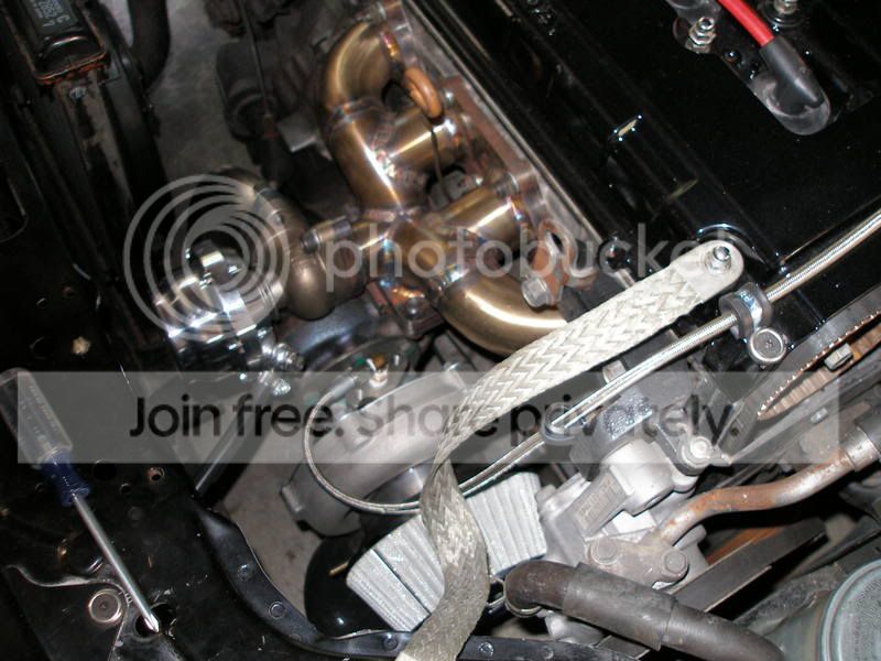

that mani looks very nice for a log style. looks like it performs well too. I like where the wg is placed.

X2. are those rota circuit 8's?

lol i said the same
nice set up.

yeah the line on the graph was real faint. jeffs printer was really low on ink, when i tried to take a pic it wouldnt show up.
setup is set at 9lbs, some creep to 10 depending on temps
wheels are rota circuit 8's bronze

Yeah, I always been a fan of the SLS mini log. You dont see too many people running them, but it's very effective for a log manifold.
Is it just the pic, or is your bleeder like almost touching to your DP?

Not a fan of body kit but it really flow well on your car. Nice job! Must be fun to drive.

I like your gauges lol, How much did all 3 cost? $500?

the bleeder is about 3/4 an inch away the pic is angled funny
the gauges i bought slowly and got sweet deals on all of them. 450 altogether, and they are brand spankin new.

clean sol, imo all sol's have to have kits!!

ive had the kit forever, im big on build it the way you like. not for other peoples pleasure

Like that front, looks good, esp with wheels...

Looks good, I'd recommend getting rid of that filter in favor of something larger.
