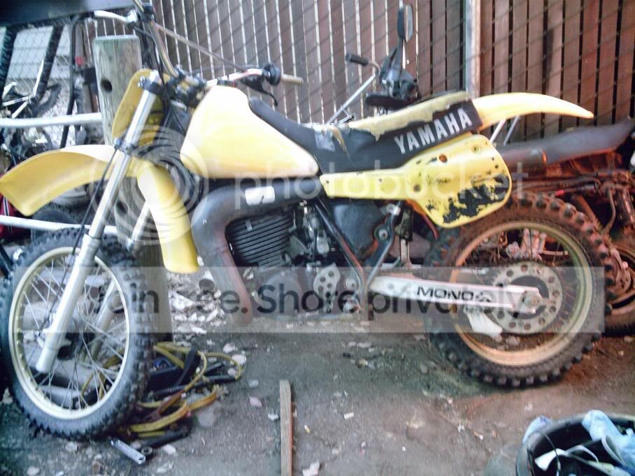

Ok, I know it has nothing to do with this thread aside from the fact that I got it for $250, and Spent $10.00 on cleaners to get it 100% up to running and riding condition.
1982 YZ490
2-stroke 487CC (5x5 chassis)
remote resivoir damping adjustable rear mono-shock
It's big, it's not too heavy, but heavy, and it has a shitload of power. Exactly what I am used to as I learned to ride in the sand on a YZ426F... discontinued because too many people were killing themselves... too much power.

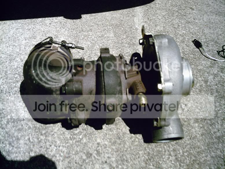

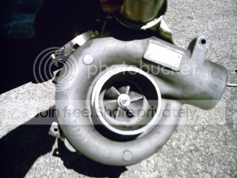

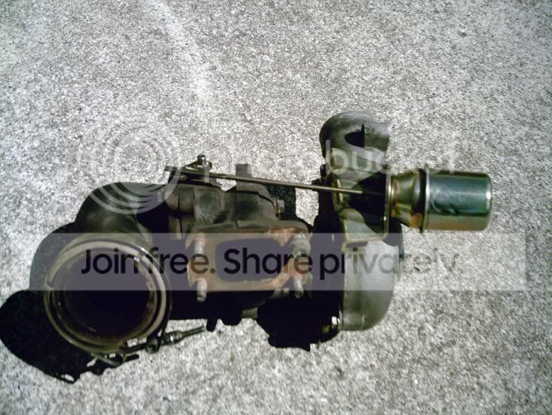

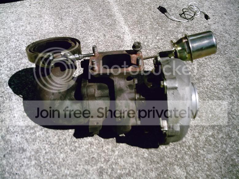

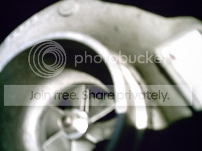

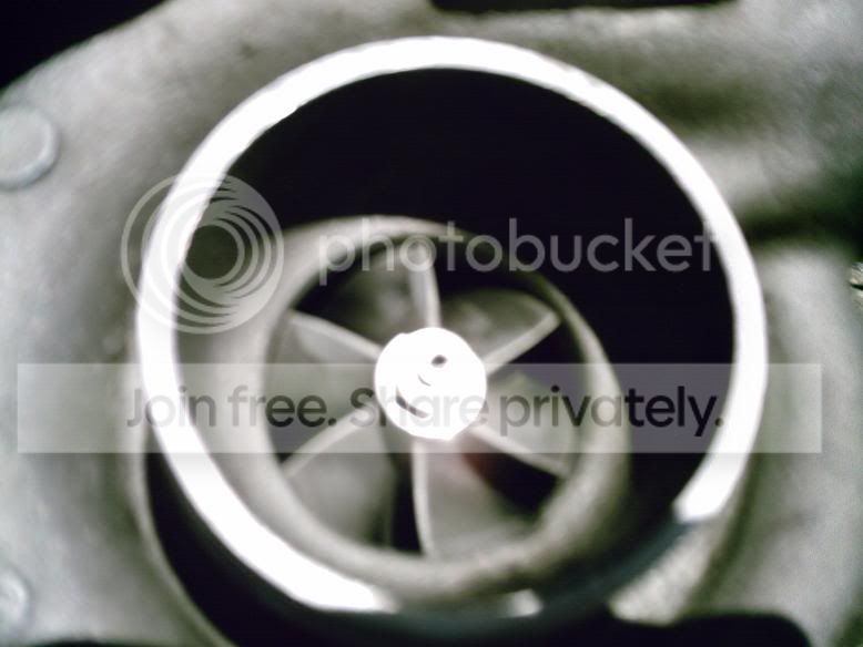

Scored again:
IHI Deisel turbo.
Markings are kinda unclear, something like .38 on exhaust housing (looks like smaller than a .48 on the exhaust housing), and the compressor wheel and housing have .52 cast into them.
It's pretty decent sized turbo, would be good for anyone really. I am considering using it, but the exhaust housing makes it want to be a top-mount if you use the output housing. (4 bolt as seen in pics)
ZERO shaftplay whatsoever... you try hard to move it it stays... I pretty sure this is a ball bearing turbo... anyone got any insight? I currently don't have access to a boroscope anymore. But.. I am putting it on craigslist for some easy cash
IHI Deisel turbo.

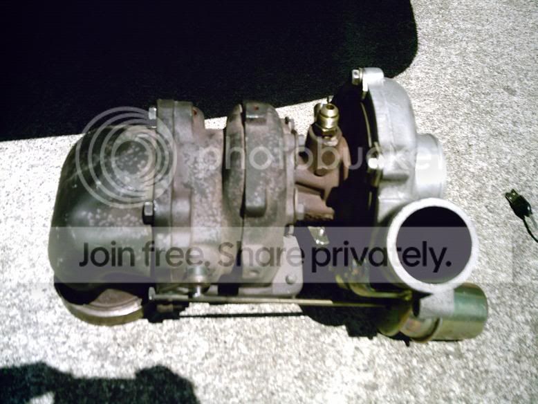

ok, got some more info:
It's an RHB62?
All the whacks out there never have any solid info on what actual series/specs this turbo is, but I do know one thing,
all of the GM1-5 turbos are exactly the same aside from wastegate routing/location (if any) and housing external shapes/mounts...
same AR, same internals.
People have been reporting these turbos good to 300-400Hp...
If I can find an exhaust housing worthy enough, I will use it instead of the .42/.48... I am told by a few different retailers that it is comperable to the T04E in regards to capability, etc.
any opinions on this?

I got the diesel turbo mounted to the manifold... I think I am going to go with it, I just need to make a brace from the DP to the block where the OEM brace mounts to for added protection. I am buying DP off of another user on this site; $100, has 2 bungs, and is suitable to use the .42/.48 untill I can get the oil lines for the GM3, DP flange fabricated (nobody makes em, and I don't want a top mount)

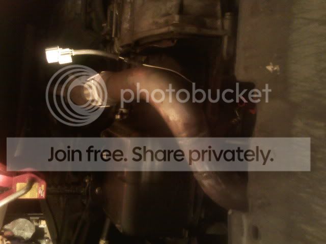

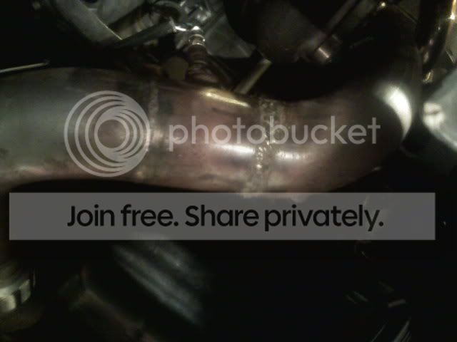

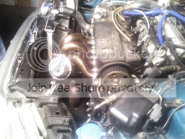

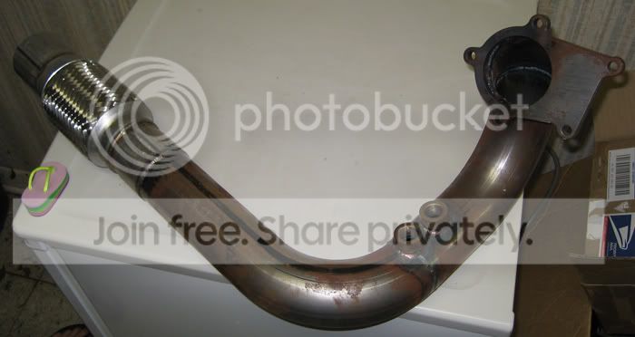

Got some work done today. I cut the DP, cut about a 15 degree wedge off of it, then welded it back together.... I only had a lincoln electric wire feed welder, so it don't look purrdy, but it will do. I will be wrapping the DP anyways. I also touched up the welds after the photos, but I think I am going to have a slight issue with my drain line... I need to buy a 45 degree bend for it, and it might work better then.... in the extreme, it will have a little pool up spot in the line, but nothing that would cause backup or a problem. I will have to get steel braded line for the drain because of it being soo close to the DP. You might be able to see in the photos.
Good news is the 2 o2 sensors fit (I hava a narrowband in the tightest location, it fits.
Here's the 3 pics I took with a cameraphone... we lost the work digital camera, time to buy a new one!
That was the mock-up stage... now we need to get the cat cut off the jetta DP, and some flanges to finish the operation. I will run a dump tube on the WG untill I get the radius bender to make the tube that connects to the WG connect to the DP.
Comments?
