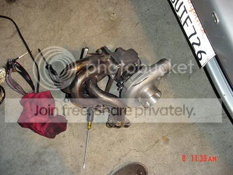

Update: got all gaskets and parts required to do the swap minus the section of charge piping between the turbo and drivers side coupler.

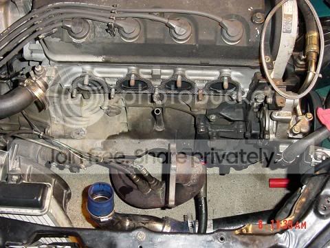

I built the D15B, cleaned and installed all the parts I could while it was outside the car.
Once the motor and everything I had was installed at 4AM, I worked at a snails pace double checking everything, and tightening everything up.
That left me only one small section of charge piping to make: the stretch between the turbo and FMIC on the D/S. After a few stops in town to pick up the last of the supplies (pipe, fittings, vaccum hose for the WG) we put it all together and fired it up. It ran like **** for the first bit: it turned out that my bade D15B rom I had made days ago got corrupted somehow. Once I figured that out, I hunted down the cause of the IACV CEL (14) and it soon dawned on me that I was a retard when modifying the dummy plug, I got it reversed.
Once I fixed the problem she started up like a dream, well a rough running dream. I got a stable base AFR (idle only) and driving home I had a lean AFR (staying below 2.5KRPM and in vaccum). I haven't had a chance to do any tning as my concentration is not so good after being awake for 32 hrs.

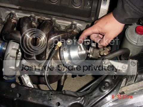

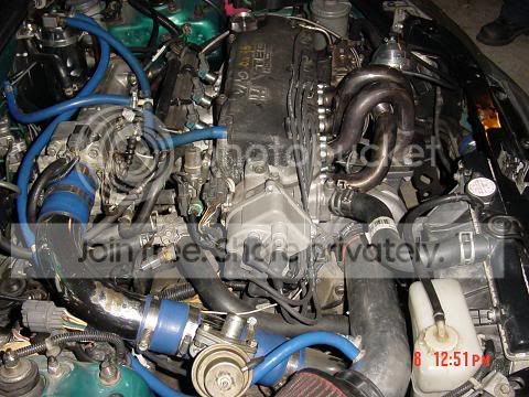

Here are 2 pics from the cameraphone. Gog away.

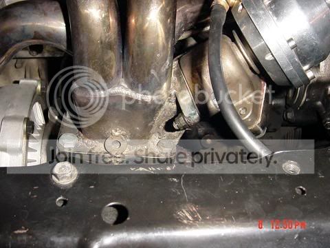

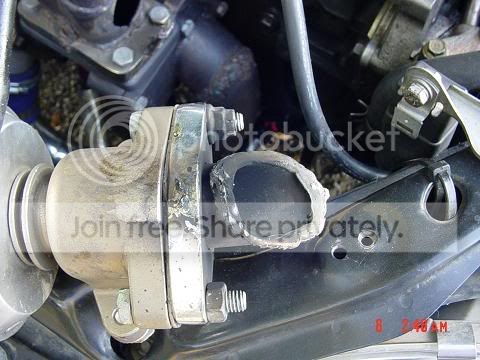

I religously check for cracks on this thing, and I found one 2 days ago forming on the flange the turbo bolts to. I watched and by yesterday it was 2x bigger, so last night we pulled the turbo and manifold off.
The braces on the mani broke clean off and one fell off when I put the slightest amount of force on it, and the turbo was blowin oil past the hot seal, and possibly the cold seal. I took it apart, it was leakin at both, and the hot side was fucked beyond repair. The turbines are still good, but the exhaust turbine is not worth cleaning up at this point, I will keep the compressor wheel.
We are leaving for pick-n-pull in a few to get another turbo.
The manifold has been re-welded, I am not sure how long it will hold this time, but whatever.

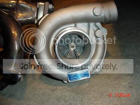

I am holding off on the TD04L; I scored a T3/T04E for a price I will not disclose, lets just say cheap as ****, and in my hand, BNIB. It may be a chinese turbo, but honestly, it can easily be rebuilt with Garrett internals. I plan to buy a new turbine shaft/wheel set (pre balanced) and swap it out with a rebuild kit when it begins to have play or leak.
Holy ****, yeah. Spool exactly where I expected it to be, between 4.6K and 5.5K. It spools way faster (when actually spinning up) then the .42/.48 I was running; though with the .42/.48 it was nice having it spool around 3.5-4K.

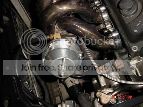

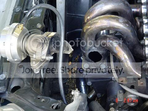

The manifold has broken on me twice now: the first crack I caught in time, the second; WG fell off completely and instantaneously while cruising at 65 on the FWY. Bolth have been rewelded and re-braced... beefed up too. So far, so good but there is better news:

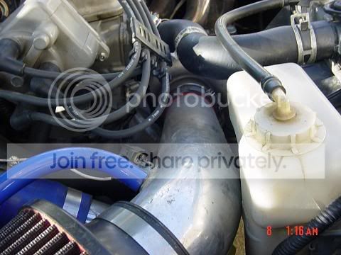

Intake: When I put the T04E on, the intake I was running would not fit, and I did not want to run a reducer coupler on my inlet. With this in mind, I put a 3" coupler on my APC intake, and pushed, and got the coupler to fit on, and suprisingly enough, the intake works perfectly, and shoots for the correct spots; u will see in the pics... hella ghetto-cheap style, but it is functional, metal, and works awesome. And for you skeptics: I am running my 1/2 rad, with the FMIC, and that 3" pipe behind the fan, and no heat issues whatsoever. Granted, the intake pipe gets warm, but if you feel the other side of the FMIC after driving; it is ice cold not warm like the other side.

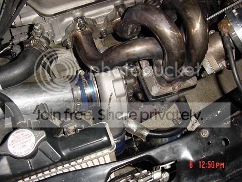

The intercooler setup had to change: Too many ricers in this area; and stupid ones at that! To date 4 people have been pulled over for trying to race me without thinking or looking; I find it humorus and laugh as I drive by. In that, I decided to paint my front charge pipes, along with the FMIC with a flat ceramic (1200 degree) paint. It looks superb, and definately made it more incognito. Plans to replace with a FMIC the size of the 1/2 radiator are in the works.
The T3/T04E is giving good results; but a bit laggy IMHO for wanting to zip around; but I think this will be different on the motor I am building and the power I will be shooting for. It makes it more economical though, staying out of boost alot more, but I did like the spool at 3-3.5K... Now a little higher, it just gives a slight delay and snaps into power which really turns the heads.

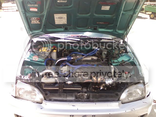

Anyways, here are some photos, and I have included a few extras of other projects and such just because
hella ghetto-cheap ...
...which really turns the heads.
Too many ricers in this area; and stupid ones at that!!!!

Work is slow; lots to do so I must go about my business; but yep Fun fun, and the manifold was worth $100. no complaints; just supporting info for the peeps out there. BUT: If I had re-welded everything on the mani before the initial install I would not have had any cracking issues.
every crack has been at the outer edge around the collector. all of the flange side welds are fine and have not had any problems.
I am however getting my new mani/DP ordered in a weel or so, so things are moving forward; I just need to keep things rolling.
