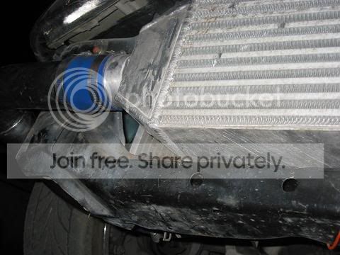

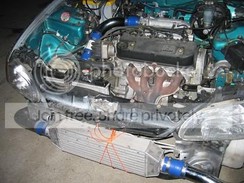

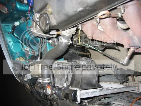

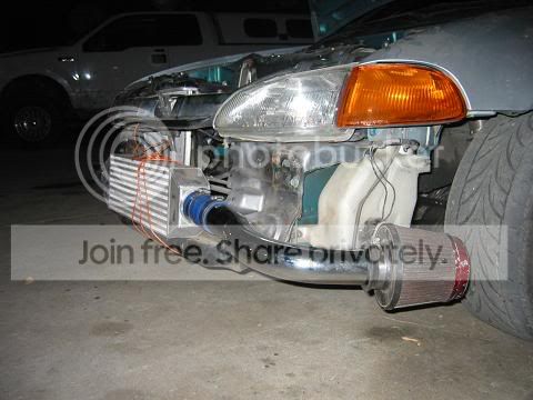

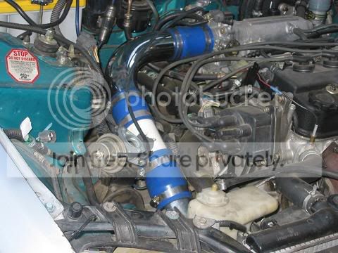

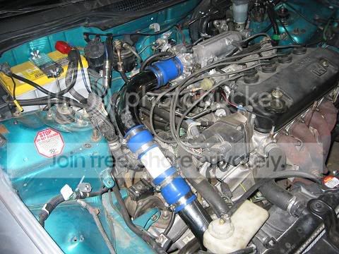

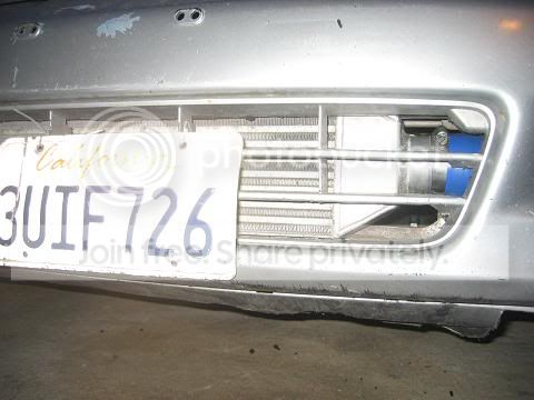

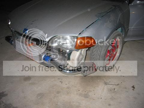

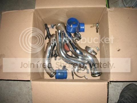

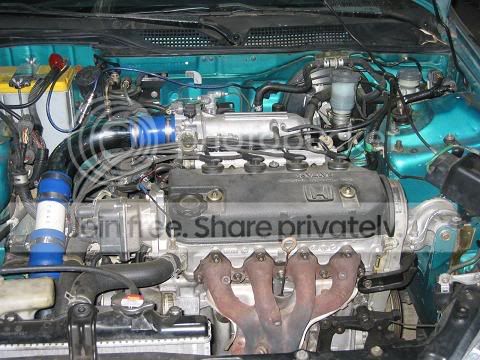

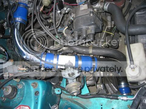

Ok, after doing the 60,000 mile service on the work truck, we pulled the ricer up, hooked the exhaust back up, and I ripped the bumper off to test-fit the intercooler and see what piping I could use and not use.
I was able to route almost 1/2 of the piping with the jetta bends, the left over peices are going to be cut up into peices that would work. Some will have to be purchased and bent but whatever.

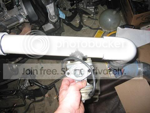

The section with PVC for mock up is actually going to be where I mount the BOV... I will put a flange on a piece of steel pipe and be putting it in it's place.
The intercooler fits nicely, however I did have to remove the bumper... so now I need to figure out some sort of mount or bracket to hole the IC in place... it is held in with some plastic weed eater wire.
I am still going to consider the K03 setup if I get a stock DX mani to mount it to, but I need to get myself a T3... for sure I will be doing that soon.
I have the fittings and oil lines, so nothing to worry about there.
Ok, it's late.. work is early... more pics to laugh at!

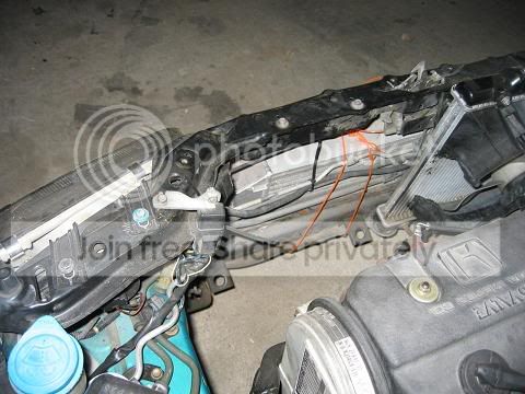

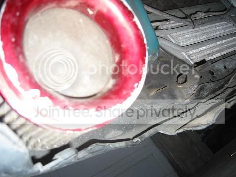

Anyways... I am back at the workshop, and have the ricer up to figure out what I am going to do about a support bracket for the FMIC... the 2 mounting tabs that were on it for the jetta broke off when my buddy took it into the ditch (reason for selling his jetta for 2K) so I need to figure something.
The radiator support panel on the Ricer is damaged... somehow it was pulled out forward and the pinch welds/tabs were ripped off/apart... so it is sticking forward a little.... it makes it difficult to make a solid mount. I think I will have to pull the 2 front tow brackets off the car completely, cause they were bent up for the car being lowered, and they are interfearing with the radiator support being able to be put back into it's correct position. Once those brackets are off, I will put the support back in place and weld it on.
I will continue, my partner came out and we are brainstorming right now

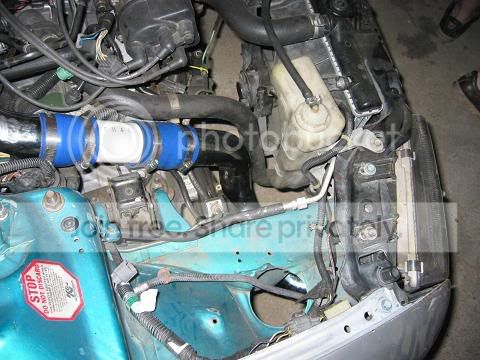

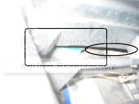

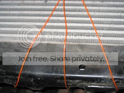

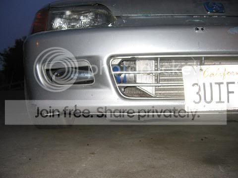

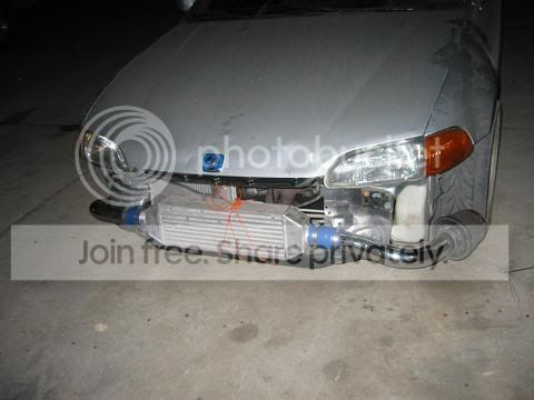

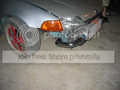

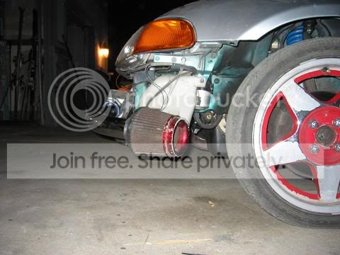

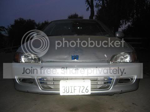

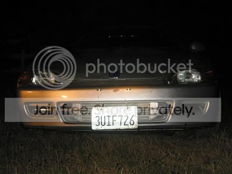

Here's the result of the brainstorming about 1 and 1/2 hrs later:
Much better.
Next I need to spray the intercooler with hi-temp flat black to give it the stealth look, but I would leave the piping polished so it throws people off. I did as little trimming of the bumper as possible to get it to fit... and the best part was I didn't have to leave the inner main bumper off, I cut a piece out of it to fit around the intercooler, and it holds it snug right against the radiator support...
So... since it fits perfectly now... needing no brackets no-less... I just need to remove the bumper to reinforce it with a piece of angle iron for support since it was cut slightly. Also I will wels supports to the lower seperated portion of the radiator support to give it some strength.
All in all, the mounting of the core took me less than hours... all that is left is to make piping to connect from the turbo to the inlet where the air filter is currently located (pretty odd hearing the intake on the drivers side of a civic...). I have the couplers, but no pipe right now, I will have to go get a length, and maybe just a U bend.
I don't have work, so I will take the bumper off and take pics of the cutout design I made to hold the IC core in place. I will probably cut the BOV section out of the old charge piping so it can be mounted on the charge piping untill I get the length of pipe needed for the rest of the kit. (to mount a flange to)
Anyways.. it's late... time to pass the expletive out.

i'm only somewhat releived to see that you actually got some metal piping IC piping in there finally....even if it IS from a Vdub...it's volumes better than PVC.

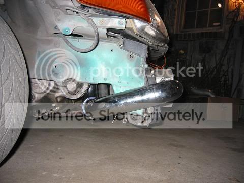

You got that right, out of a volvo... I used one of the oil flange bolts to atach it to the oil drain flange whn I got the turbo from pick 'n pull.
Anyways, I am waiting to get myself a new T3 because I won't have the time to fab up a manifold for the K03 Sport....
With the piping: Right now, it is going from the TB to the intercooler on the passenger side, through the core, and it goes out of the core to a filter that is mounted there untill I get the turbo back on.

Anyways, I got the BOV cut out of the old piping, and mounted in... I plan to make a new PVC system for when we dyno... I still have enough left over to get the job done.

Above: The intercooler is held against the lower portion of the radiator support, and the top is being held in (just tight enough) by the bumper. I cut a notch and part out of the bumper [[Squared off selection]], and it hangs just down far enough to securely hold the IC core in place[[Rounded Selection]], but not block any cooling fins. Origionally I was just going to cut out and box in the bumer around the core, but when I made the first cut, and fitted it up, it seemed I didn't need to do anything else.
As for the other 2 pics, they speak for themselves.
