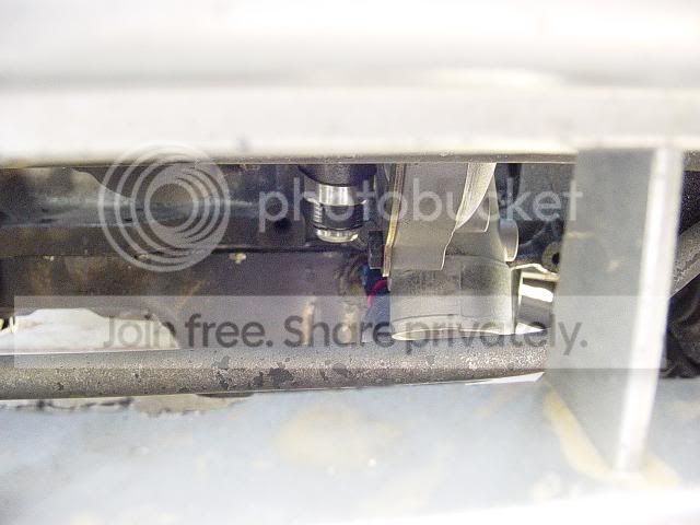

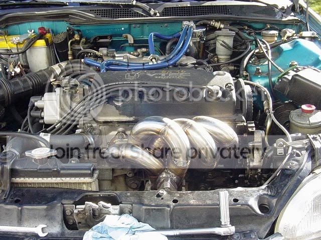

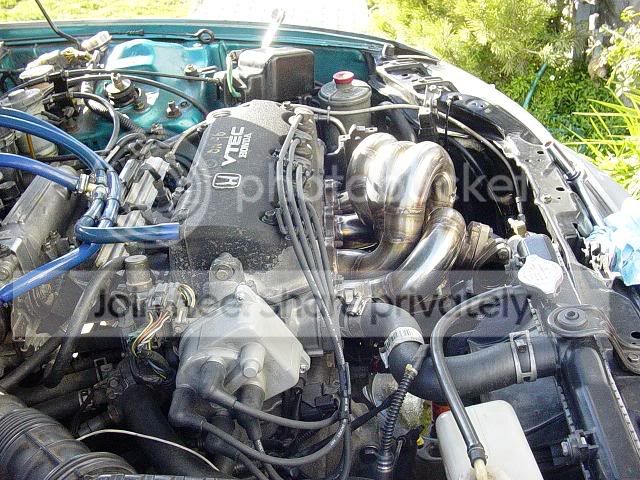

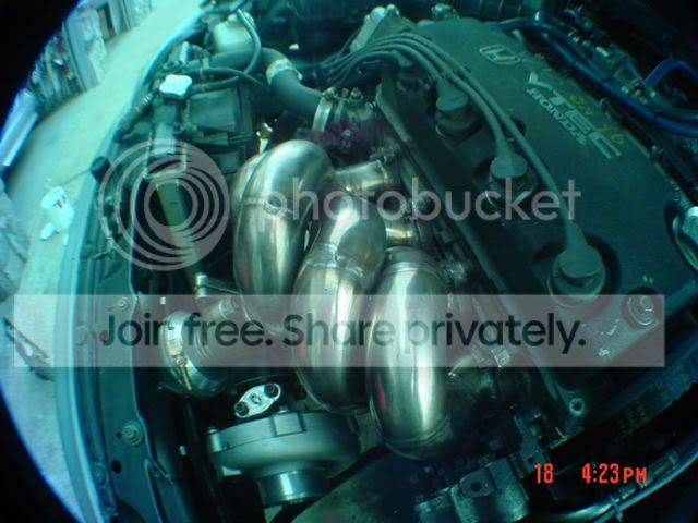

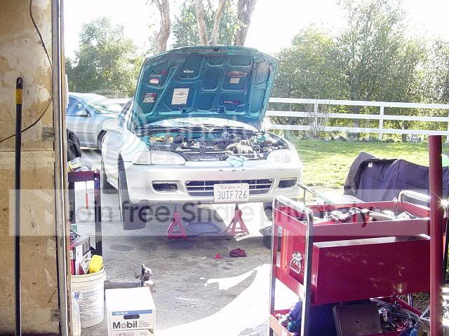

Ok, test-fit complete here are the notes:
Evertyhing fits perfectly, drops in without a shoe horn; No clearance issues anywhere on the board: pleanty of DP room, but it will be somewhat of a pain to bolt up the WG and DP flanges once complete....
Check out the pics:
I'm gonna need a shorty air filter....

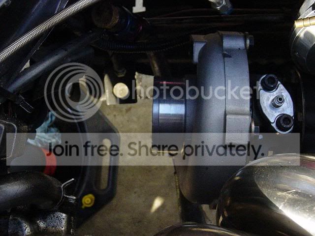

Oil drain line is almost in-line... pretty sweet compared to last time....

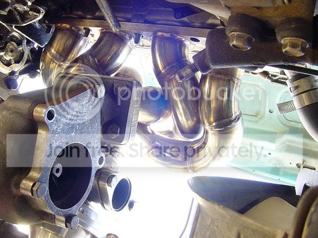

Bottom view of WG/DP flanges...

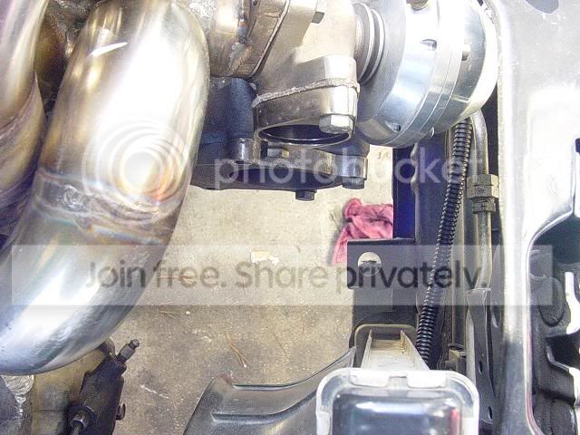

Top view of WG/DP flanges

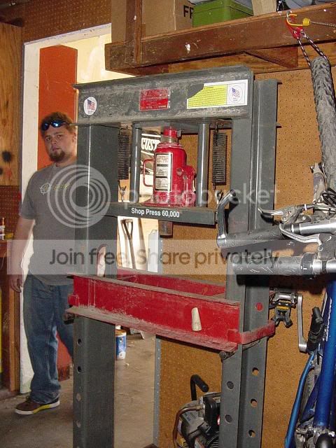

This is what an unused $200 press looks like... Latest good deal we got for the shop
Check out the pics:

I think I am going to stay away from XS's ramhorn; if I want a ramhorn I will fab it myself... it's symmetrical enough I could do it with a hand tubing bender and alot of patience.
This new mani is a nice peice of work for $200; worth $300 or $350 if it has been cleaned up more on the inside; I will be doing that myself in the next few days or so.
For the DP I am trying to find a local supplier so I can get some 304 or better stainless make a DP
At the worst it will just be STD steel, but I think I can afford to buy the material and make a nice DP.
I was also lucky enough to not have any clearance issues at all; This is definately a good thing; I was kinda worried seeing is how the WG flange/section was soo poorly "splotched" on there with alot of tig wire; but it's thick and solid, so no worries bout that weld
Only possible thoughts of bracking the manifold from the rear from the exhaust inlet to outlet flanges, and from the DP flange to the block as well; I don't think I will have to worry about it cracking on me; unless I hit a curb or something; but I plan to have countermeasures in place to prevent it from happening again.

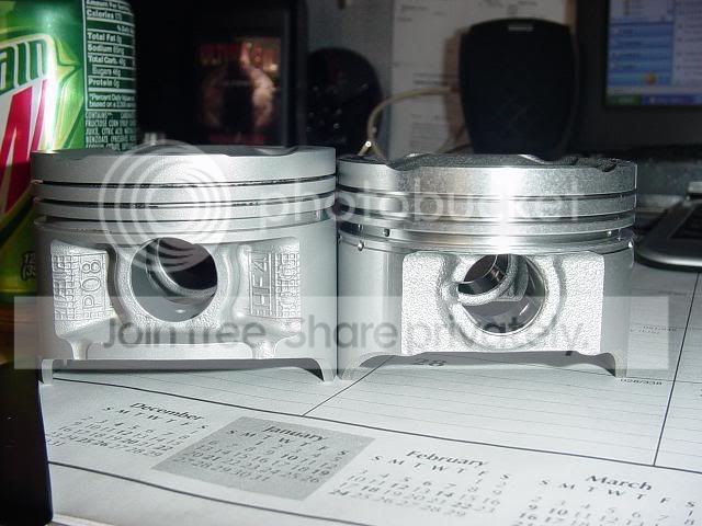

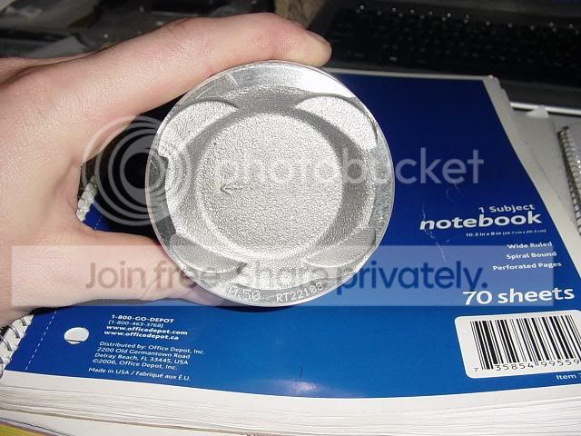

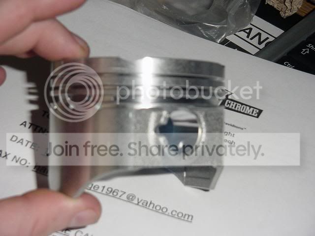

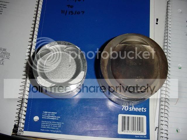

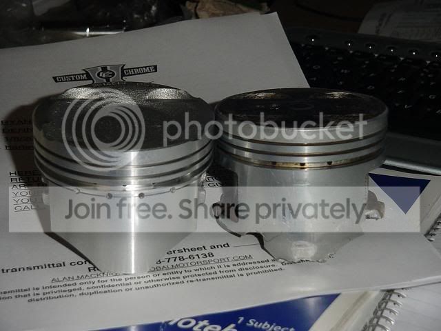

New 75.5mm slugs in the mail.... these things are little babys compared to the ones in our company's "RevTech" motors
75.5mm
soo tiny... pretty light too. and You can see the teflon coating; kinda looks a little spotty.

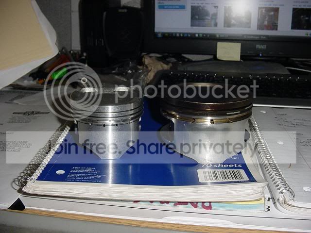

next to the PM3 piston that came out of the motor that was in the ricemobile when I got it.
Next to a RevTech 100" piston
All the guys at work laughed at how "cute" the pistons were and asked if they were for my lawn mower; I told them nope, they are for my rice cooker!
75.5mm

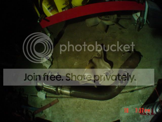

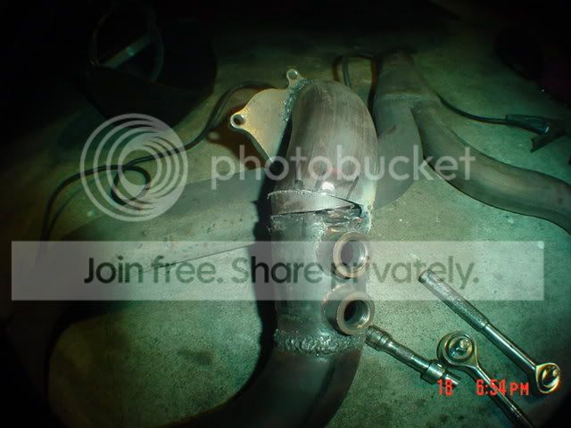

The results of hacking up 3 old DP's and making one using nothing but a skill saw and a crappy wire-feed welder.
New LC-1 in the mail; Everything is coming together.
More TBA!

P2W will be .0035
Gaps
Ring upper: .019
Ring lower: .020
