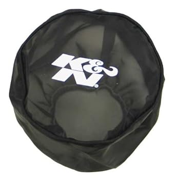

Originally Posted by NotARaCist
That seems like it'd do a great job of sucking water straight up off the pavement.
They make Filter bags to prevent that. Its not like a CAI where it goes directly into the throttle body and the engine is all of a sudden trying to compress water..
In addition, most honda turbocharged don't sit so low that it affects it anyway.
Any Honda turbo that has a compressor facing the driver (US) fender typically is smart enough to make a 90* or 45* to face downward since there is no other room. Its all in the configuration.
I have one of these myself.
It fits over the filter like this:
Not even a full $21
Amazon.com: K&N RX-4990DK Black Air Filter Wrap: Automotive Amazon.com: K&N RX-4990DK Black Air Filter Wrap: Automotive
