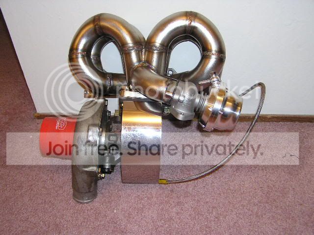

I made a true cold air setup, turbo inlet tube is T304 stainless to avoid heat soak, the U bend (not shown) is aluminum, there's a huge K&N filter at the end which resides in my right inner fender. I also have a venturi tube in the turbo inlet tube that helps evacuate my crank case.

Default Re: (Boondock Saint)

<TABLE WIDTH="90%" CELLSPACING=0 CELLPADDING=0 ALIGN=CENTER><TR><TD>Quote, originally posted by Boondock Saint &raquo;</TD></TR><TR><TD CLASS="quote">I made a true cold air setup, turbo inlet tube is T304 stainless to avoid heat soak, the U bend (not shown) is aluminum, there's a huge K&N filter at the end which resides in my right inner fender. I also have a venturi tube in the turbo inlet tube that helps evacuate my crank case.
Did you have any trouble with your clutch hardline? I can't get my aluminum elbow on, b/c of this hardline.

<TABLE WIDTH="90%" CELLSPACING=0 CELLPADDING=0 ALIGN=CENTER><TR><TD>Quote, originally posted by scartail &raquo;</TD></TR><TR><TD CLASS="quote">Did you have any trouble with your clutch hardline? I can't get my aluminum elbow on, b/c of this hardline.</TD></TR></TABLE>
No, no problems there, perhaps your manifold puts the turbo at a different angle?
Can you bend the line out of the way?
