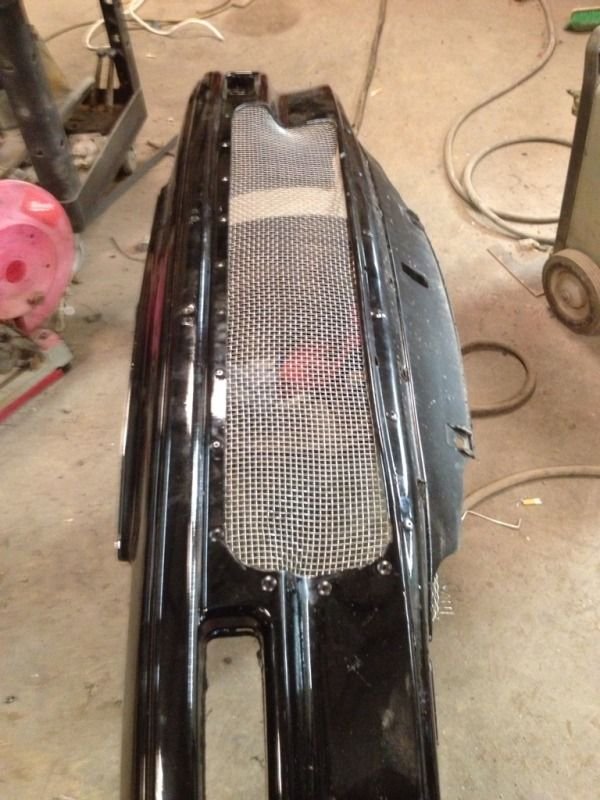

I later painted the mesh black.

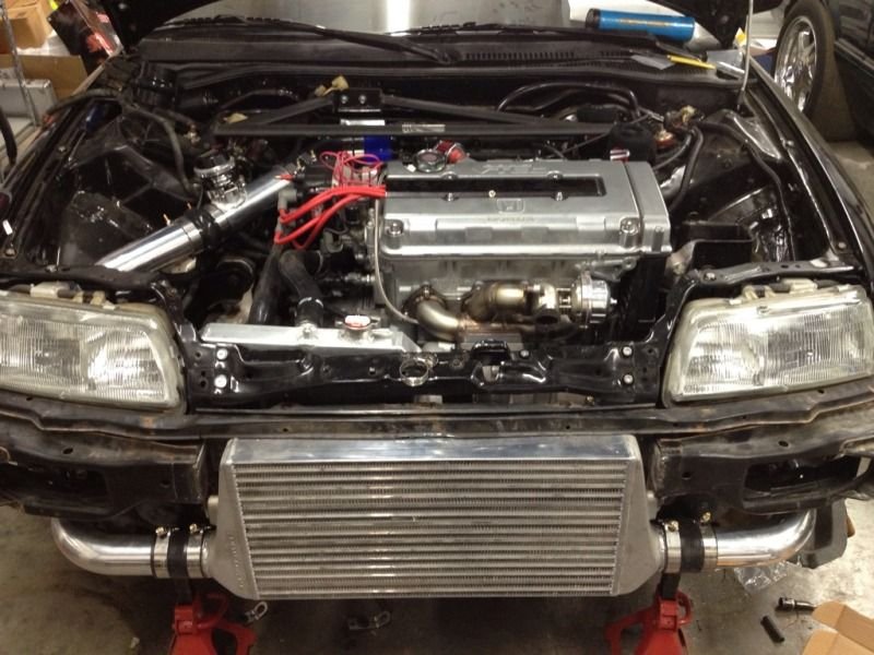

Crx: 650hp Precision took some doing on the 90-91 crx bumper with the air dams cut and bit of trimming up front on the grille... I had an HF so the stock bumper bar was the thin one... Probably could of even gone as big as the 750 one...
