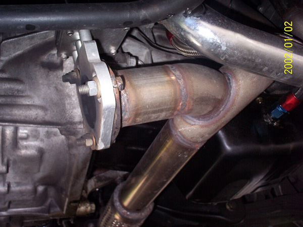

Ok well I have two questions to ask.
I have been doing some research on e-cutouts and they fall apart. I would like people to say the pros and cons about the one they have on there car, how long they have had there’s and things they did to help longevity. These are the ones I have found.
http://www.quicktimeperformance.com/
http://www.mccordcg.com/mpp/mpp.htm
http://www.dmhperformance.com/
I’ve heard people saying vibration is a big issue with e-cutouts. Im doing a setup like this. Do you guys think if I put a flex pipe under where the oil pan is on the DP it would help with vibrations?
this is accordfreak pic
thanks

Well We offer the quicktime ones Through our site.
I personally have one on my daily driver.
I've been using it about 3-4 months now and Had no problems with it other than sealing. I generally Keep it open, I feel Bad when i make my car breathe through the 2" tubing that i setup after the cutout.
From the Situations I have seen, The ones that tend to fallapart are the ones that stay close a majority of the time and Are in a bad spot in the exhuast where there is consideranble amounts of vibration.
I run Solid mounts and the cutout about 8"s off my turbo and there is quite a bit of vibration and Ive taken it off a few times to check it and Eveything is still cool.
I run a Dump on the end of it with no mounts on the turbo or Downpipe.
The flexpipe on that setup seems to be for the WG. I dont see it tied into anything of the Cutout

I don’t think you quite understand me. Maybe I didn’t work it correctly. Putting a flex pipe it the middle of the DP under the oil pan to help vibration.

heres some pisc of the very 1st atp cutout on a honda i just installed. BTW i welded up accordfreaks downpipe too while back.
some pics for you to gawk at.
old downpipe

Look at this Pic of the atp IMO,No offence to the person that owns this car . This is not a very good design. To me that’s just a hole on the side of the exhaust. The exhaust gasses are flowing in a strait line. Then there’s this hole at a right angle in the middle. Most of the gasses are going to keep going strait. But in the pic at the top of the thread. When the cutout is open the gasses go strait out of the DP. No restriction what so ever. And for tuning , I’m running two different maps for the open and closed settings. I plan on keeping the cutout open most of the time.
I think im just going to buy one . If it brakes im going to make my own setup. Im going to try to fab up something like a throttle body that’s cable actuated. But it would be spring loaded. So when you pull the cable it flips closed. Then when you pull the cable again it flips open. I would also weld everything so nothing could vibrate loose. What do you guys think?
my thoughts exactly.. IMO, you would want your cutout in the straightest path possible, and route the stock exhaust however restrictive way you can, since if you're running a cutout, you obviously are worrying yourself with trying to get the least back pressure from your exhaust system...
mount the cutout in line and route your stock exhaust off to the side..

like in the pic at the top of the thread.
