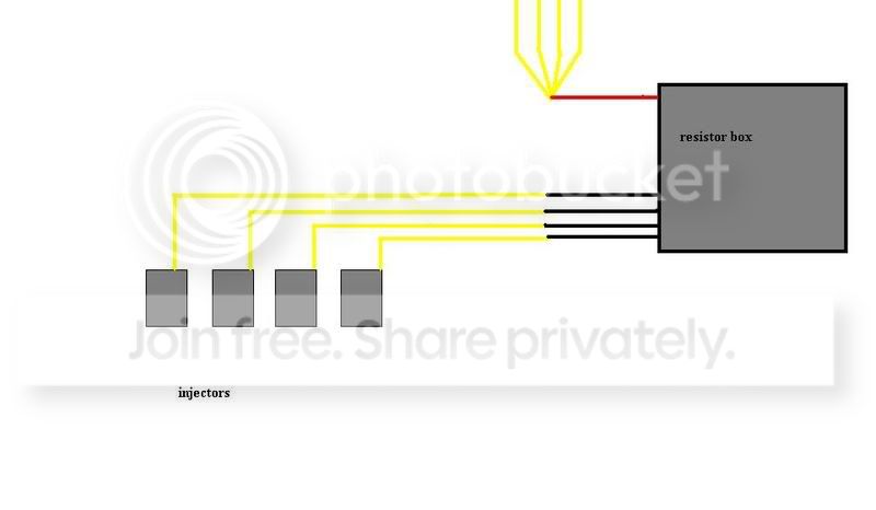

damn what a mess... all you need to CUT are the ones that are yellow/black... the others NO NOTHING NADA...
if you are using a honda civic/crx 88-91 or DA resistor box..
you take the 4 yellow ones that are NOT going to the injectors and you solder them together to the SINGLE RED cable on the resistor... the other 4 BLACK cables coming from the resistor are going to the Injectors... yes through the same yellow blacks you just cutted...
So CUT the 4 yellow blacks...
so now you have 8 yellow blacks.... 4 from the harness of the car and 4 going to the injectors..
the 4 from the harness of the car u put solder them together with the lone RED from the resistor Box
the 4 BLACK coming out of the resistor box go to the remaining 4 yellow/black to the injectors...
OOHHH you made me get my leet skillz on paint for this one... i think this is as mistake proof as i can make it at 5 am.

good job. thats what i was trying to explain.

thanks guys thats alot easier to understand!
