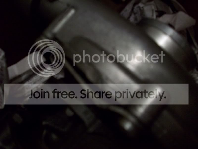

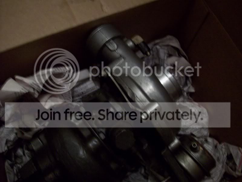

i just got a junkyard turbo and when i recieved it it had a little dent.. just wondering if the dent will cause problems? thanks!

as long as the seal is ok.. does it look messed up where the housing meets the cast part? i would take the plate off and hammer it flat and bolt it back on.

Looks like a Volvo turbo you got there. I would say it needs to be checked to make sure it did not bend the seal plate. If you sent it to a rebuilder a good used seal plate is like 20 bucks.

yea it is an old volvo turbo im gonna use for my b18b. the seal doesnt look broken so i think im good.. but do you know of a reputable rebuilder? i wouldnt mind to see how much it would be to get a rebuild.. thanks!
