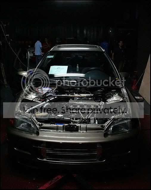

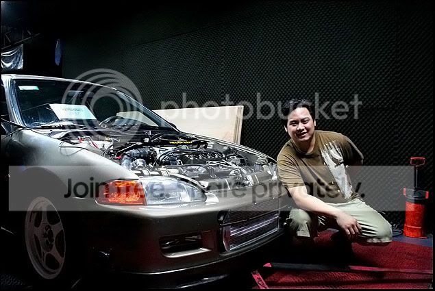

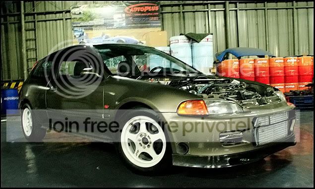

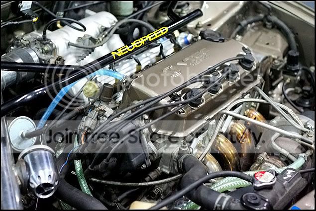

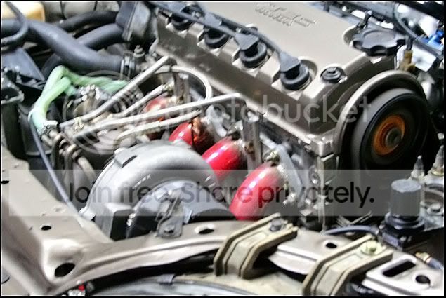

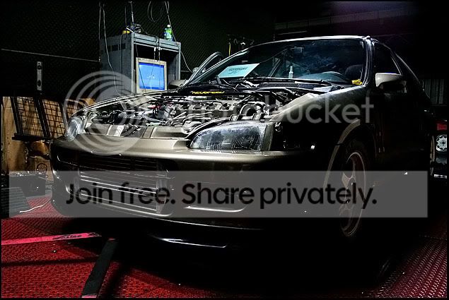

I was there at the Autoplus dynojet when this beast was tuned. Some pics. Enjoy.
Old Mar 23, 2007 | 03:10 AM
  #90
zap's Avatar
zap
Posts: 493
From: Japans Junkyard, Manila, Philippines
the man and the "budget" car..hahaha
blurred pic because I got scared, the turbine was so loud at full boost, and the wastegate dump tube was firing towards my legs.

change that banjobolt on the filter most restrictive pos i have ever seen
