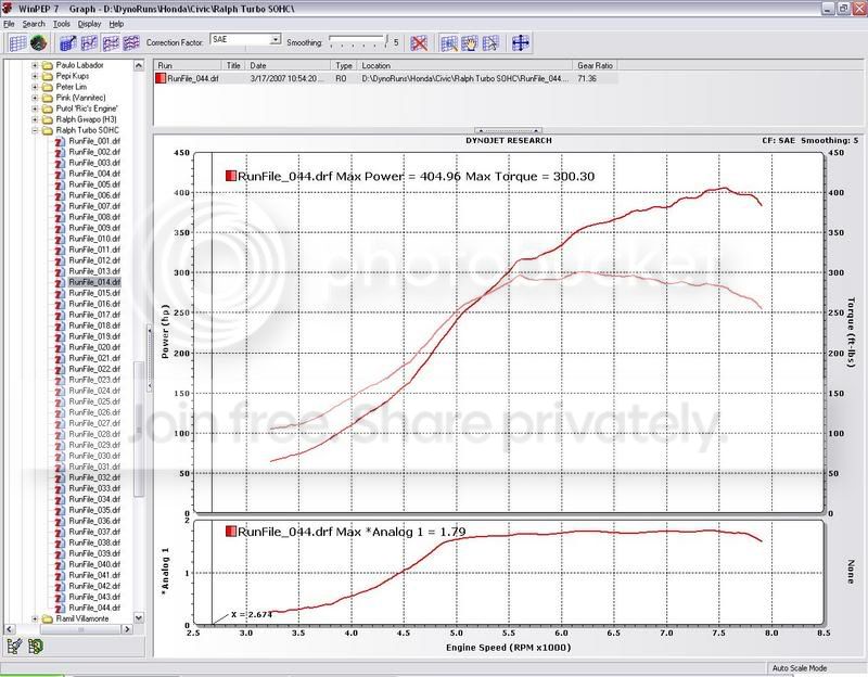

Old Mar 17, 2007 | 07:10 PM
  #64
ralph11sec's Avatar
Posts: 777
From: MANILA, PHILIPPINES, philippines
Default Re: (sohc_turd)
d16zc
fully headworks by H3
ported intake manifold by H3
vitara piston
eagle rods
zex cams
zspeed intake manifold
zspeed valvetrain
zspeed camgears
stock sleeves. no block posting. no block guard.
with a/c
gt30R
tial 38mm wg
hks ssqv
local topmount and pipes.
taiwan intercooler
precision 880cc
walbro pump
sard fuel reg.
3" DP
manual boost controller
end results:
95octane = 304whp at 18psi
100 octance = 404 whp at 26psi
red hot manifold
firing exhaust!
look at the manifold lol
404 run
Old Mar 17, 2007 | 07:12 PM
  #65
ralph11sec's Avatar
Posts: 777
Default Re: (Laserjock)
lol. yeah. ill probably go there next year. look for a job and green card. lol
stupid bosch pump. we replaced it with the stupid noisy walbro pump. idle fp was 38. as boost comes in it raises to 50.
i also had problems with the taiwan clamps and rubber hoses(for aircon), we had to replace it with sard silicon tubing and t clamps. 1.7 bar is reaaaaaaaaaaalllly scary. or maybe it was just my first time. lol
